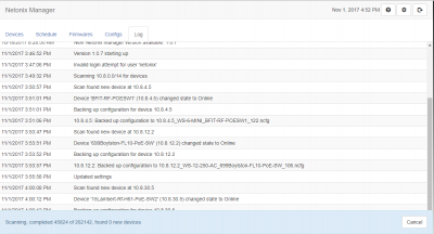

1. On startup there were a set of log messages from September (see image 1 below). I'm not aware of having done anything with this software in September.
2. A minor annoyance: The scanning message shouldn't overlay the log scrolling area! (also visible in Image 1 below).

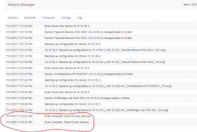

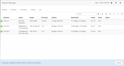

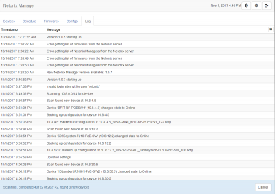

3. I started a scan of 10.8.0.0/16. It found three devices rather quickly but clearly had a long way to go. On the assumption this would take many hours but would finish before I returned, I added another scan (for 10.12.0.0/18). This caused the # of devices found to reset to zero even though the original scan was obviously proceeding and the devices display still shows the three devices found so far. (Images 2 & 3 below). When I came back, the 10.8.0.0/14 scan had found all 51 switches that are actually in the range 10.8.4.5 thru 10.10.211.2.In addition, the scan of 10.12.0.0/18 had also found 5 switches in the range 10.12.25.3 thru 10.12.35.2. So I now have 56 switches in the "Devices" list but the log is as shown in image 4 below. I conclude that you can add an additional scan before an earlier one has ​completed and it will work but the count will be short by however many devices had already been found when the second scan is initiated, i.e. defining a new scan resets the counter even if an existing scan is in progress.
4. A day later I've scanned my whole network. I should have 156 Netonix devices but there is no easy way to get a count of what the manager has found, short of scrolling and counting lines (some single, some double) on the screen.
5. Now having counted, I see the Netonix Manager has only found 134 devices. I don't see a way to print out a list as my number of devices far exceeds the window in the web page, i.e. when I print the web page I only see the dozen or so radios visible at any one time, not the whole list. So now I will have to scroll through comparing entries to my NetXMS list (which I can print). Even better than printing might be the ability to export the Device list to a .csv file. Then I could print it and, even better, format it for convenient DIFs against the NetXMS output.
