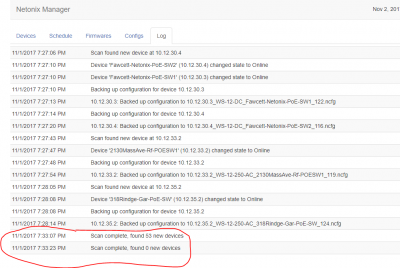

1. On startup there were a set of log messages from September (see image 1 below). I'm not aware of having done anything with this software in September.
2. A minor annoyance: The scanning message shouldn't overlay the log scrolling area! (also visible in Image 1 below).

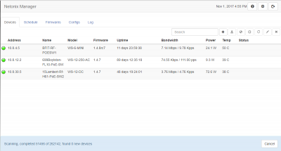

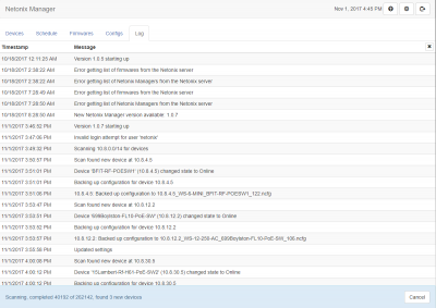

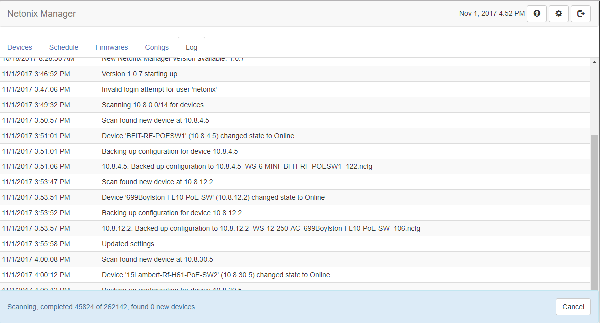

3. I started a scan of 10.8.0.0/16. It found three devices rather quickly but clearly had a long way to go. On the assumption this would take many hours but would finish before I returned, I added another scan (for 10.12.0.0/18). This caused the # of devices found to reset to zero even though the original scan was obviously proceeding and the devices display still shows the three devices found so far. (Images 2 & 3 below). When I came back, the 10.8.0.0/14 scan had found all 51 switches that are actually in the range 10.8.4.5 thru 10.10.211.2.In addition, the scan of 10.12.0.0/18 had also found 5 switches in the range 10.12.25.3 thru 10.12.35.2. So I now have 56 switches in the "Devices" list but the log is as shown in image 4 below. I conclude that you can add an additional scan before an earlier one has ​completed and it will work but the count will be short by however many devices had already been found when the second scan is initiated, i.e. defining a new scan resets the counter even if an existing scan is in progress.

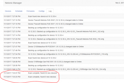

6. I like the Manager's ability to display log alerts but the display window that comes up is too narrow and can't be widened (see image 5) enough to display the whole alert.
