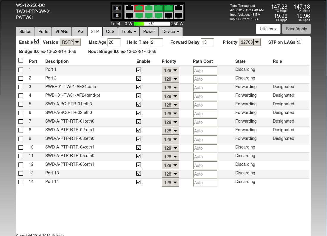

Screen shots of the tabs are below.

With that out of the way, here are the switch tabs for switch 1. Switch 2 is nearly the same except for PTP link names and minor port differences.
(Regretting that I never created a dedicated switch domain vlan...]
All other tabs have defaults.
