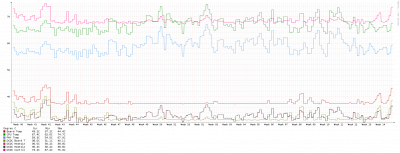

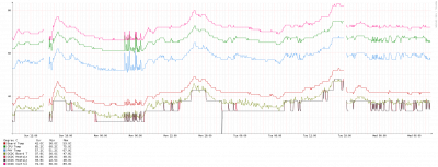

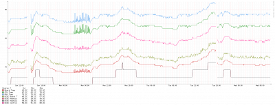

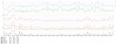

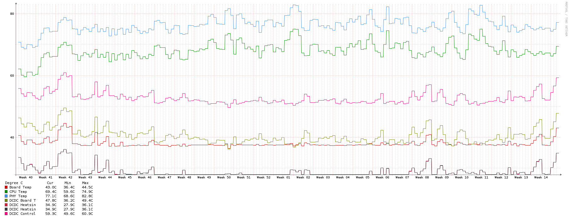

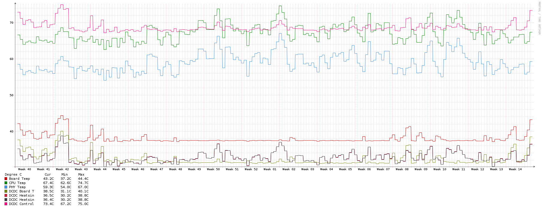

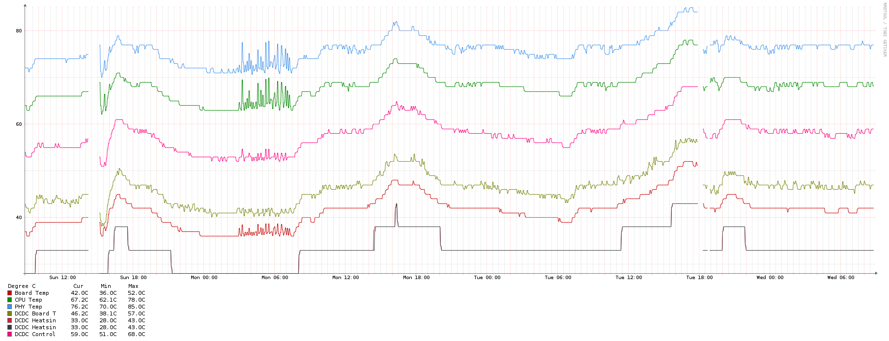

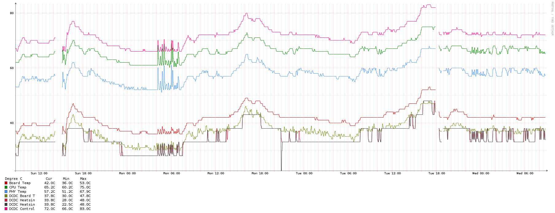

I'm bringing up the fans because I'm thinking about the device temps given the charts below.
Switch 1 recent history (this is the switch that become non-responsive)
Switch 2 recent history
Switch 1 full history
Switch 2 full history
What I find interesting is that the temp profile for the two switches is so different. (Note that switch 1 powers the AF24, while switch 2 powers a AF5x.)
For instance the PHY Temp and the DCDC Control Temp.

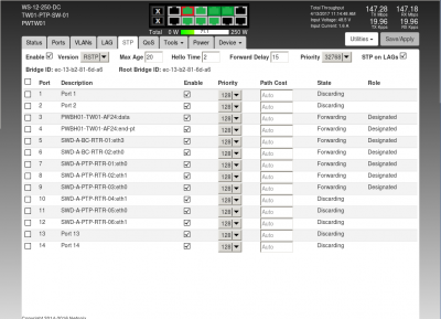

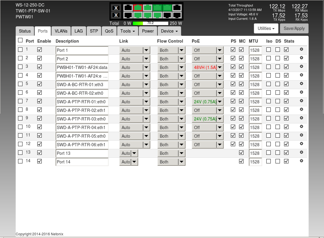

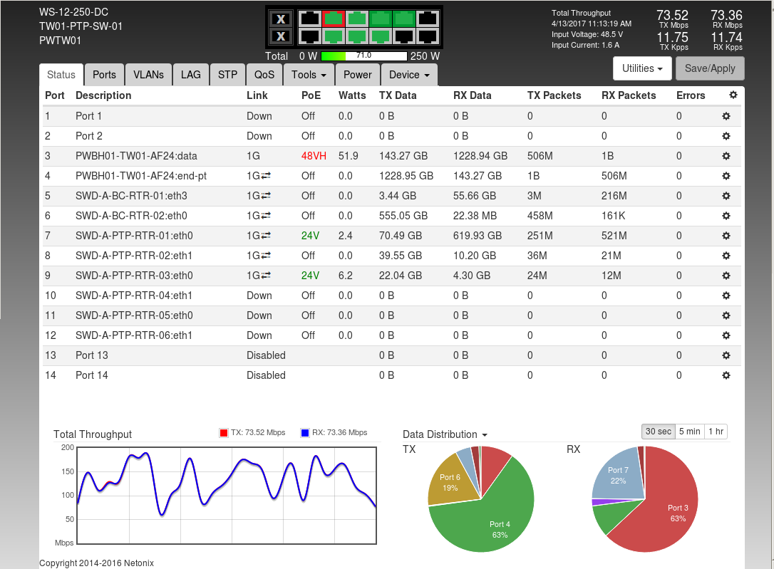

Screen shots of the tabs are below.

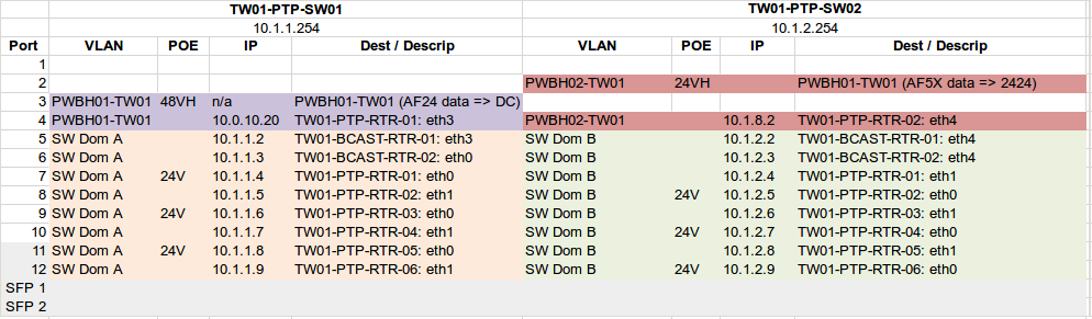

However, a bit of explanation is likely required. My config is based on Jim McNally's design for redundant routers. My initial implementation is described here.
In short
Jim's design requires that all of the PTP and BCAST routers are interlinked on the switch domain subnets. This works fine when the number of ERXs are few, but gets somewhat messy and the number of ERXs increases.
My current implementation uses the WS-12-250-DCs to primarily support switch domains. Simpler and cleaner physical cabling. Each PTP router has one cable to each switch and a third to the radio.
This describes the port usage of both Netonix switches.
(Note, all IP addresses listed are on router ports except for the switch IPs: 10.1.1.254 & 10.1.2.254)
If a radio only needs 24V then the radio is powered via the POE passthru of the ERX.
However, when a radio needs either 24VH or 48VH then the physical connection is ERX -> Netonix -> Radio data/poe port. And in this case the Netonix ports have a dedicated vlan for the PTP link.

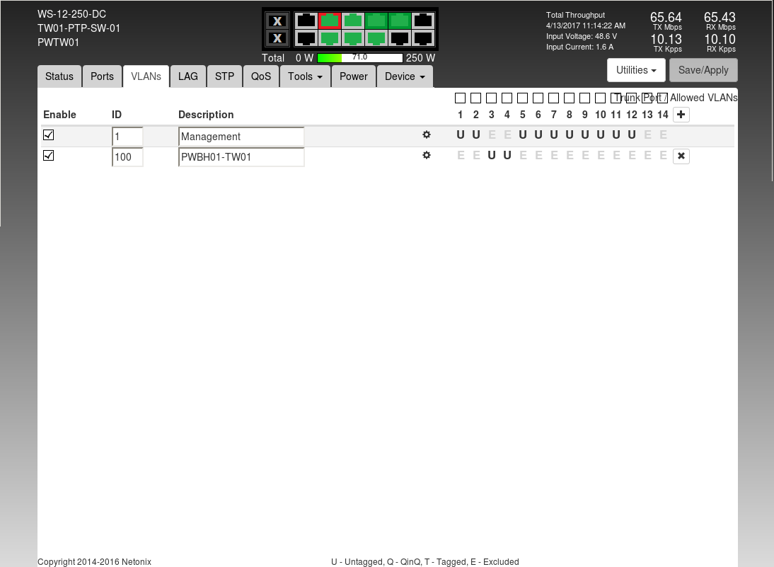

With that out of the way, here are the switch tabs for switch 1. Switch 2 is nearly the same except for PTP link names and minor port differences.
(Regretting that I never created a dedicated switch domain vlan...]
All other tabs have defaults.

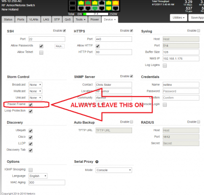

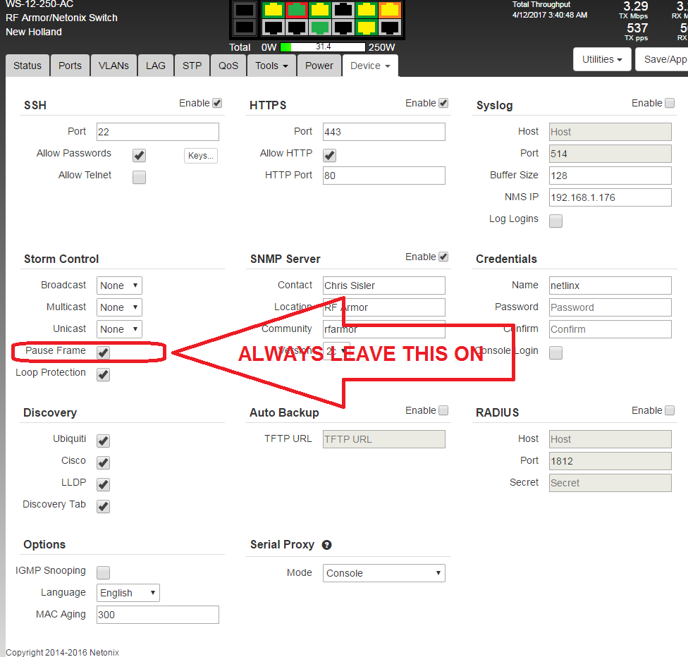

Also Turn on Pause Frame Storm Protection on the device configuration Tab, it is STUPID to ever turn this OFF as it "can" sometimes detect a Pause Frame Storm and disable Flow Control which is the same as unplugging the cable.
