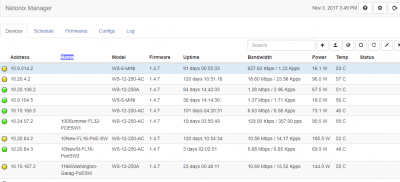

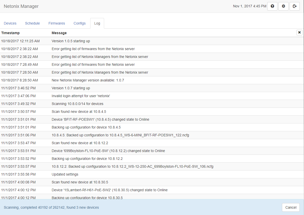

1. On startup there were a set of log messages from September (see image 1 below). I'm not aware of having done anything with this software in September.
2. A minor annoyance: The scanning message shouldn't overlay the log scrolling area! (also visible in Image 1 below).

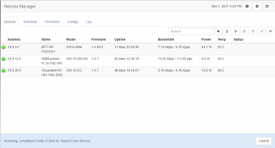

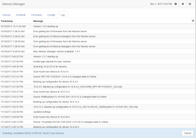

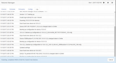

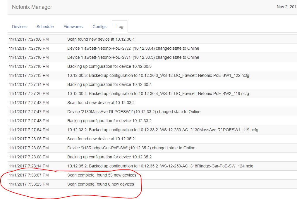

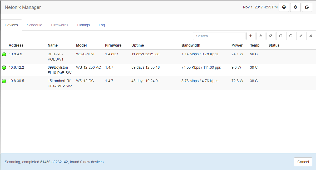

3. I started a scan of 10.8.0.0/16. It found three devices rather quickly but clearly had a long way to go. On the assumption this would take many hours but would finish before I returned, I added another scan (for 10.12.0.0/18). This caused the # of devices found to reset to zero even though the original scan was obviously proceeding and the devices display still shows the three devices found so far. (Images 2 & 3 below). When I came back, the 10.8.0.0/14 scan had found all 51 switches that are actually in the range 10.8.4.5 thru 10.10.211.2.In addition, the scan of 10.12.0.0/18 had also found 5 switches in the range 10.12.25.3 thru 10.12.35.2. So I now have 56 switches in the "Devices" list but the log is as shown in image 4 below. I conclude that you can add an additional scan before an earlier one has ​completed and it will work but the count will be short by however many devices had already been found when the second scan is initiated, i.e. defining a new scan resets the counter even if an existing scan is in progress.
4. A day later I've scanned my whole network. I should have 156 Netonix devices but there is no easy way to get a count of what the manager has found, short of scrolling and counting lines (some single, some double) on the screen.
5. Now having counted, I see the Netonix Manager has only found 134 devices. I don't see a way to print out a list as my number of devices far exceeds the window in the web page, i.e. when I print the web page I only see the dozen or so radios visible at any one time, not the whole list. So now I will have to scroll through comparing entries to my NetXMS list (which I can print). Even better than printing might be the ability to export the Device list to a .csv file. Then I could print it and, even better, format it for convenient DIFs against the NetXMS output.

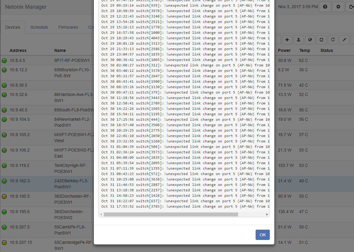

6. I like the Manager's ability to display log alerts but the display window that comes up is too narrow and can't be widened (see image 5) enough to display the whole alert.

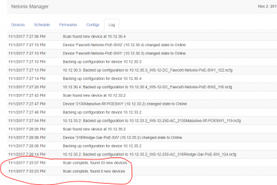

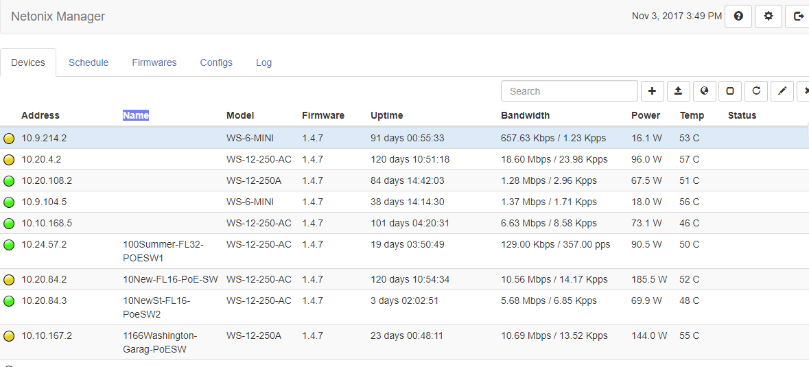

One of our guys killed our Internet access briefly so I lost my VPN tunnel into our network and everything in the Netonix Manager turned red. I re-established the tunnel about a minute later and things started turning green, however, some devices appear to have lost the device names during this interruption. It's been five minutes since connectivity was restored. Everything turned green (or yellow) very quickly but these five devices are still without names:
Any ideas?
How do I get the names back?

On the 5 devices which have lost their names... I tried re-scaning the address range of one of the devices. That did nothing. I then deleted one of the devices that had no name and then re-scanned the /24 address block it was in. It was found immediately and has been restored. Of course I can do this for the other four devices as well, but it would be nice to know how this happened and how to avoid it in the future.
