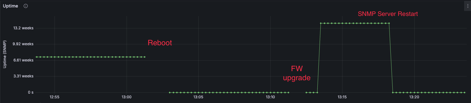

Just noting something that we've seen occur occasionally after upgrading to 1.5.26 (seen on 1.5.25 as well).
The timetick count increases to 14.3 weeks after the upgrade has been completed. Restarting the SNMP server will resolve it - or rebooting the switch. We're grabbing the timeticks from OID 1.3.6.1.2.1.1.3.0 (sysUpTimeInstance). This doesn't occur on every host we upgrade, but it happens on at least half.
