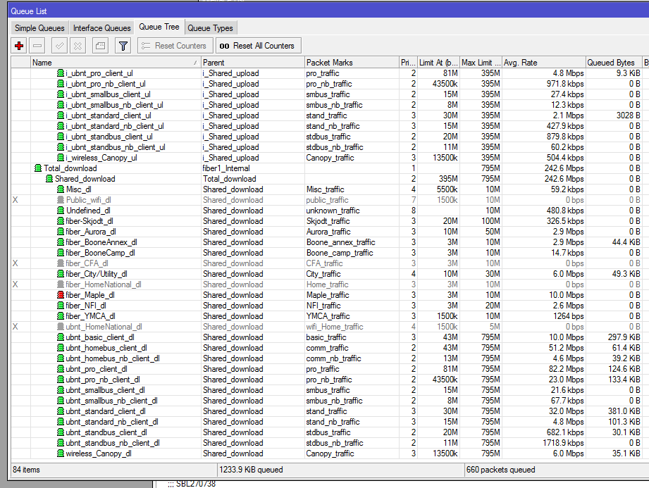

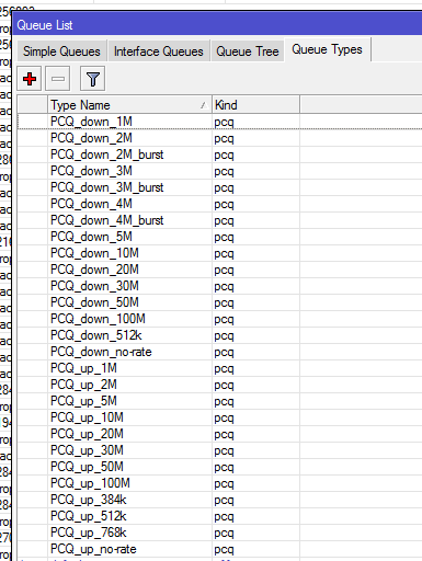

For what it's worth I shape my customers download/upload at the Edge with our router (x86 Mtik). Also each customer CPE is shaped at the CPE for upload traffic.
On the edge I use the Mtik Firewall Mangle+Address lists to mark each connection by the customer's IP address and then use a Queue Tree to control the rates. Each customer is assigned into the speed category they are purchasing. Then I use PCQ w/burst for my download/upload queues.
Works quite well and I have been doing this setup since around 2012.
