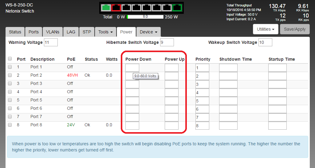

I'm also extremely annoyed/disappointed by the complete lack of real documentation. A FORUM IS NOT DOCUMENTATION.
For example, I've been searching for (literally) 15 minutes trying to find the definition of what "Power Down" and "Power Up" mean on the Ports tab.
An improperly/poorly documented product is one that doesn't have a place in my network, and it looks like Netonix isn't going to have a place past the trial unit I bought.
Re: Manual?
valnet wrote:I'm also extremely annoyed/disappointed by the complete lack of real documentation. A FORUM IS NOT DOCUMENTATION.
Well then one can ask a question like you just did however I can not answer this question as there is no "Power Down" and "Power Up" on the Ports Tab?
Maybe re-ask the question with more accurate information.
Are you asking about input fields maybe on the Power Tab?
If you mouse over the box it puts up a range 9.0V to 60V which means power OFF this port if the input voltage from your batteries drops below the voltage you put in the box and then power it back ON when the voltage reaches the voltage specified in the other box.
I know this is a stretch but think about it. This is a smart DC switch which means it can accept input voltage from 9V-60V and is designed to hook directly to your battery bank so if the batteries start to discharge one can tell the switch to power off less important ports and then turn the port back on when voltages recover.
Does this make sense now?
