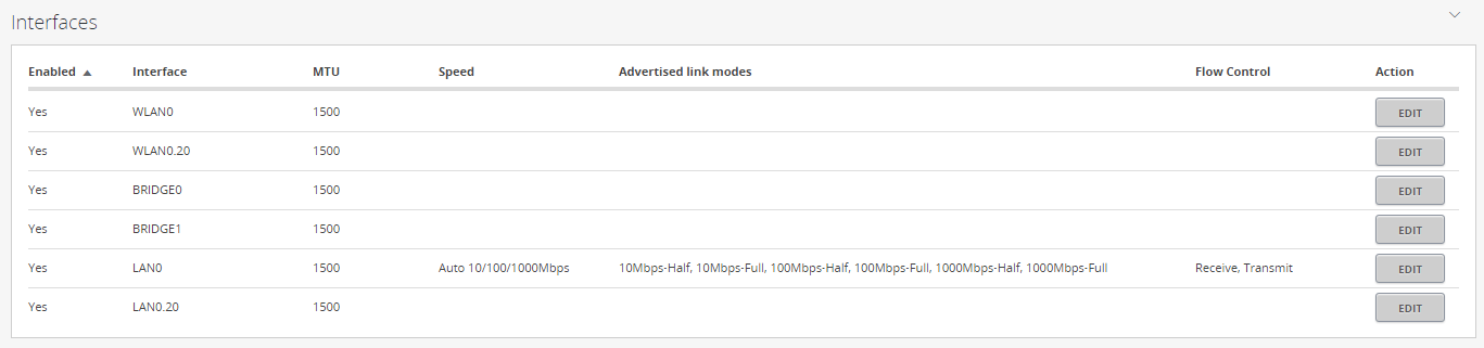

Newest firmware, both 8.0beta6 and 7.2rc4 has Flow Control option. Under network / Configuration mode "Advanced" / Interfaces....
