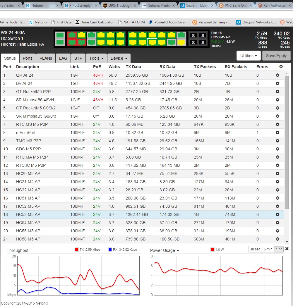

Anybody else seeing 10,15, as high as 22W being used by RM5's on 24v ports?
The devices are listed as pulling a max of 8W, so I'm just curious. I'm seeing this on firmware 1.2.2, at multiple sites.

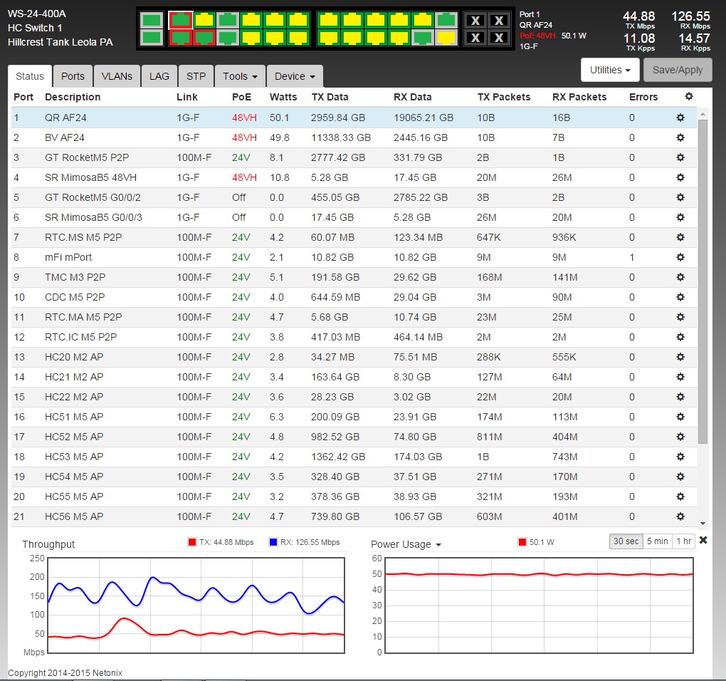

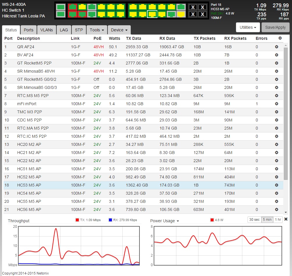

Below are some screen grabs I just made showing a Rocket M5 AP.
The first screen grab is real time reporting every second where you can see where the radio is transmitting as the power consumption spikes. If your radio is transmitting a LOT then it will warm up and the radio power consumption will increase with the radio board temperature, that's just how it works, the hotter it gets the less efficient it is.
The second picture is the 5 minute history where it averages the data so it starts to flatten out.
The third picture is the 1 hour graph which the average power consumption levels out.
The last picture shows an AF24 on the same switch drawing just about what Chicago said it would 50 watts +/- a a couple.
So the last graph shows the switch properly reporting what the AF24 power consumption right where it is supposed to be which tells you the switch current sensors are calibrated correctly.
