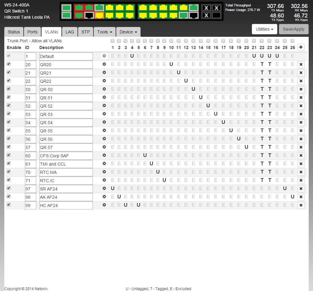

First, THIS HAS NOTHING TO DO WITH MTU. I don't know why you would think enabled/disabling the IP on an interface has ANYTHING to do with MTU.
Chris, we just had a MASSIVE power outage that effected the entire peninsula all the way up to Anchorage.
When devices came back online, one of our sites DIDN'T. On a hunch, I enabled the vlan IP on the wispswitch going to that site and the site IMMEDIATELY came back online.
WTF? Screenshots attached.

Re: VLANs ... "finnicky" (1.2.2 and prior)
Wed Jun 24, 2015 3:42 pm
VLAN 1000 is (obviously) a tagged interface that goes over an AF24 link to a TSPro on the other side.
This is the 3rd time that traffic to that vlan from this site has stopped. Every single time, enabling the IP address on the vlan interface has caused traffic to instantly start flowing again. Once it starts flowing, you can disable the IP on the interface and traffic continues.
I have *never* seen anything like this before.

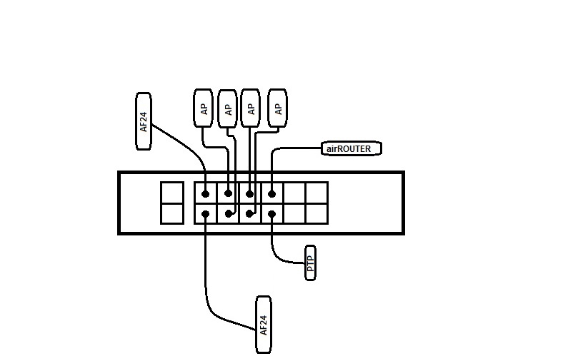

I sure could use a network diagram to help wrap my head around how you're expecting your network to function.
On the diagram can you detail out what equipment is in each port and if there are VLAN's configured beyond the switch.

Chris,
This segment is a large bridged network where each site is split off by VLAN.
There is nothing complicated about this setup at all, and it worked FLAWLESSLY whenever we had our TSPROs in place at this site. We replaced the TSPROs because of reliability issues and packet loss long term. All of our other wispswitches are working well with their configs for the most part, and we only see this issue upon initial deployment and, longer-term, at this site repeatedly.
Port Descriptions
1 AF24 data/mgmt* to head end K0x site
2 AF24 data/mgmt to HDx site
3 AP
4 AP
5 AP
6 AP
7 local host cpe (airrouter)
8 Private PtP link
9-14 unused
* (most of our AF24 sites have separate management cables, but this is an older site and they haven't been ran... yet)
VLAN 172 is the local vlan for the site. It is untagged across the board (AF backhauls there are untagged management), but the upstream/downstream devices are only looking for tagged traffic, or converting the untagged traffic to tagged on the inbound.
VLAN 466 carries private multilink traffic to a customer with several sites, ports 2 (backhaul to HDx site), 4/5 (APs)
AND THE IMPORTANT/RELEVANT ONE
VLAN 1000 is the vlan for the HDx site. It exists on the two AF24 ports only (Just noticed it was enabled on unused ports 11 and 12, so disabled those.)
VLAN 1000 is the one that drops, sometimes randomly, but often when there has been a power outage. Looking at the historical data on the AF24 link, it's signal is impeccable and doesn't vary more than 3dB on it's short link. Yay Alaska, where we don't get heavy rains for crap.
