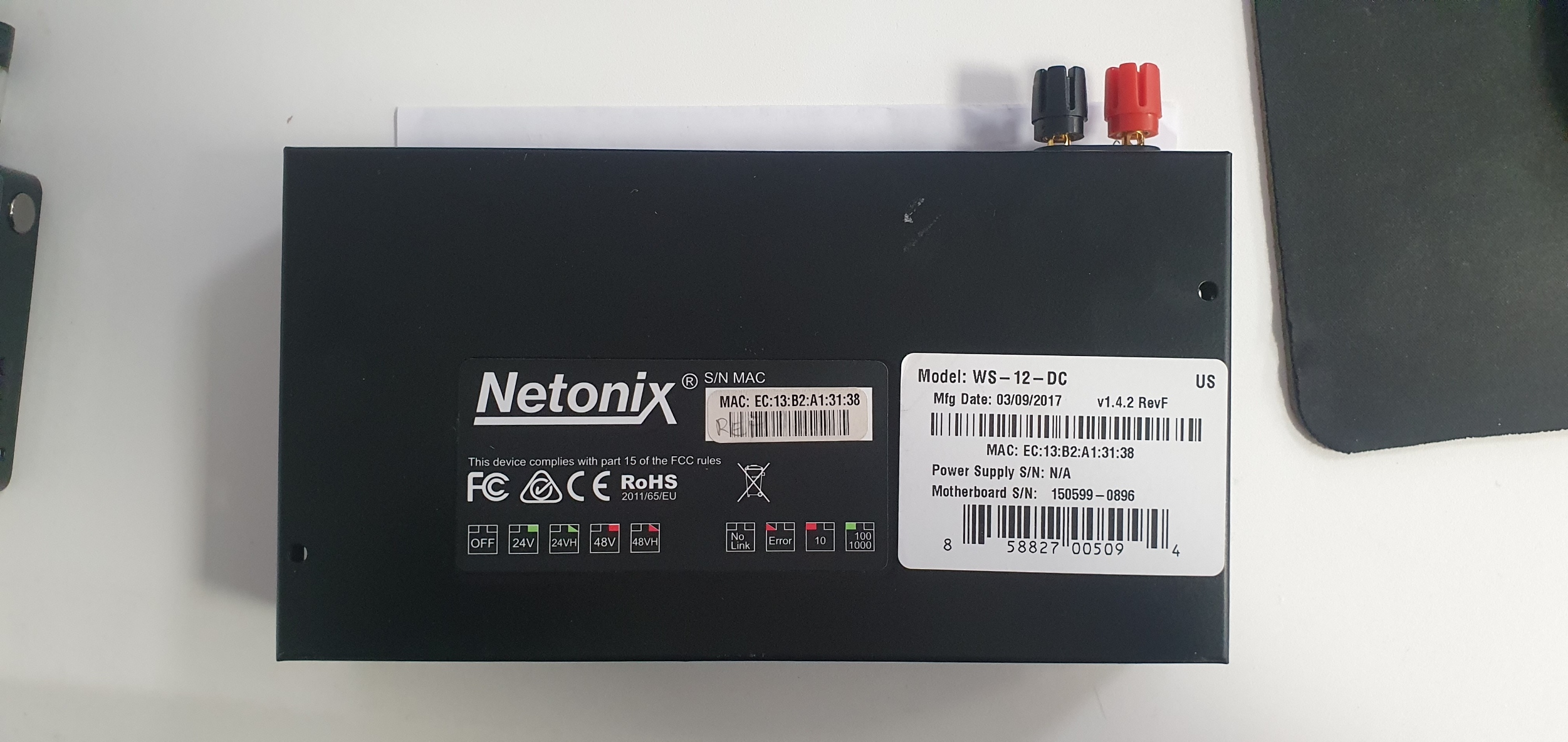

The MAC: in your pic is ec:13:b2:a1:31:38 which says it is a WS-12-DC not a WS-12-250-DC
We sold and shipped that unit to VARIA System GmbH on 03/28/2017. You can get this info from the RMA portal by plugging in the MAC address.
It would help if you did not cut the top of the screen off so we can see what the switch thinks it is (model), please repost pic showing top of UI.

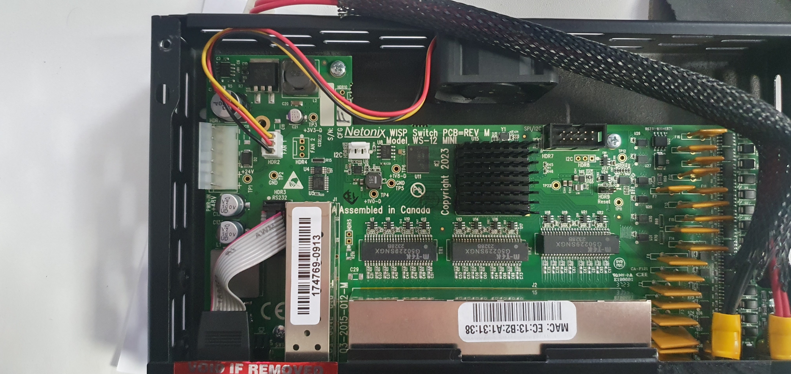

If you can open the switch and provide a pic of the board showing the serial number that would help figure out what happened.

Good morning,
sorry, I missed the image upload button.
Yes, it is a WS-12-DC. I read the model from the UI rather than from the label.
I attach:
switch labels (The black one on the left is the original and the white one on the right is the one that came with the replacement board):
Labels
Switch board photo:
Board

Posts: 7634
Been thanked: 1361 times
Re: Power Supply i2c communication error
Tue Dec 31, 2024 12:13 am
So looks like someone screwed up on our end.
The good news is I can fix this remotely.
Pull unit from service.
Setup on bench with a public ip or behind a public IP nat with a port forward so I can SSH into it.
Send IP or IP of NAT with port forward to SSH PORT so I can SSH into it. Also user and password.
You can send info to chris@netonix.com
I will login to it and resetialize it as a WS-12-DC and not as WS-12-250-DC.
