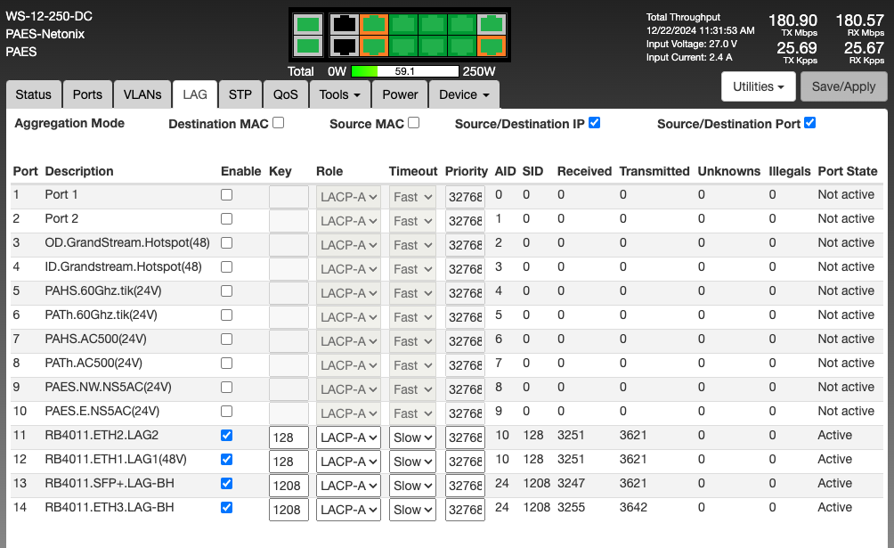

Please define what you call a trunk. (Show list of allowed VLANs or if blank)
Please post up pictures of your Ports, LAG, and VLANs Tabs of a switch which has the issue. It can be with the older firmware so its working.

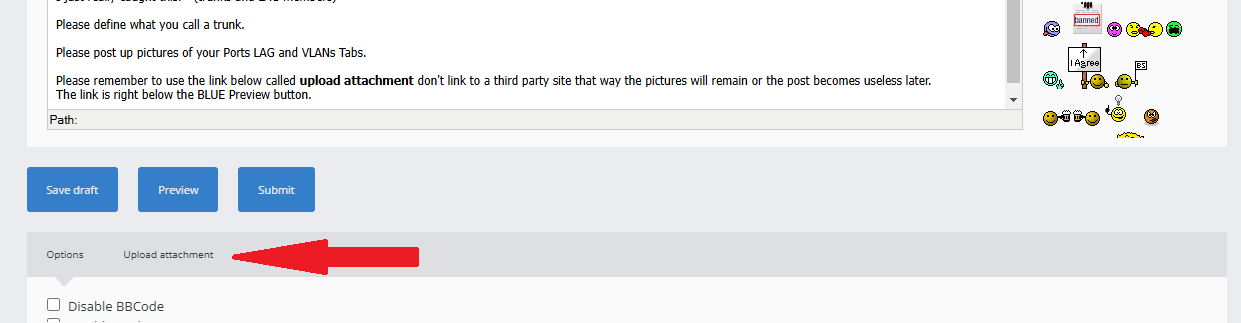

Please remember to use the link below called upload attachment don't link to a third party site that way the pictures will remain or the post becomes useless later.
The link is right below the BLUE Preview button. You can then put your cursor inside the post and click the grey button below the uploaded file name Place inline to position the picture within the post where you want it. (This is more of a reminder to all users)

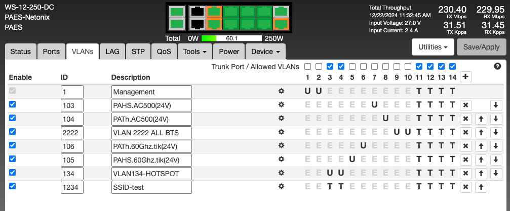

I'll provide the pictures of the setup of the switch with the issues that started after yesterday's upgrade below.
However, on the other switch where this issue started after last week's upgrade, we have done work to isolate the problem and the port in question (SFP P14) is no longer a trunk (just has a single U on a single VLAN), and is no longer a LAG member - yet the OSPF still isn't working over it (I wrote about it in detail -- multiple posts -- but I guess it's hard to follow many public forum posts).
Anyways here goes - two LAGs, two members in each:
VLANs (allowed VLANs in the Trunked ports are all of them 0-4095).

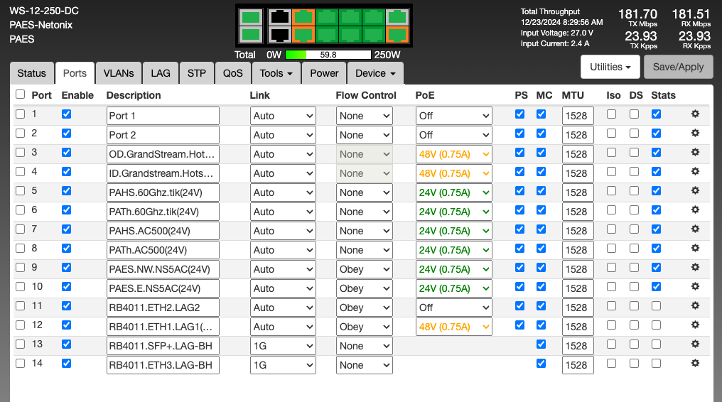

Added "Ports" tab.
Added "Ports" tab.

Re: v1.5.24 Bug Reports and Comments
yahel wrote:...
Edit above post - add Ports Tab please, important
Also specify Trunk ports with VLAN list or if blank
As I said screen shots can be from v1.5.14 or what ever version works for you
