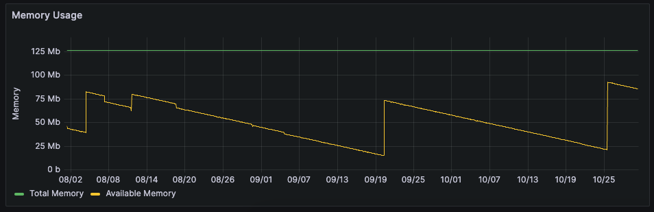

- jpmoller
- Posts: 32
- Joined: Thu Oct 03, 2019 3:24 pm
- Has thanked: 7 times
- Been thanked: 5 times
Re: v1.5.15rc1 Bug Reports and Comments
Unfortunately, the SNMP memory leak appears to still be present on the one host we have deployed the new firmware on.
Far right peak is the reboot with the new firmware applied. Rate of available memory depletion is the same as when it was on 1.5.14.
Dave - Employee
- Posts: 729
- Been thanked: 158 times
Actually, you will note the far right ramp starts with higher memory available then the previous two ramps.....memory usage will grow with use, but new code should limit that...would be good to see it further on..
but in the meantime can you share below:
- switch model
- your switch configuration
- which oids you are querying on snmp
- share /var/log/messages and your snmp log.
- switch model
