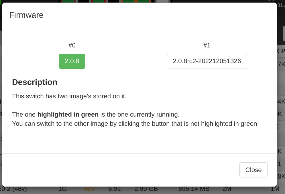

Re: v2.0.8 Bug Reports and Comments - WS3 Firmware
When I upgraded to 2.0.8 from 2.0.8RC2-202212051326, the device did not successfully complete the automatic reboot process after the new firmware was applied. It remained with all ports turned off for 15 minutes, after which I unplugged the power cable and forced another reboot. It appears to be fine after that.
Therefore, for anyone else upgrading, ensure you have someone on-site; don't do this remotely.
