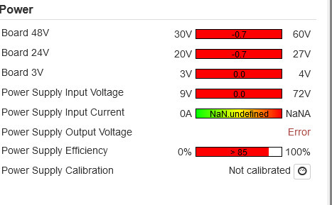

Put this onto a switch to try it out, now the switch under Watts says error.

rclark wrote:Put this onto a switch to try it out, now the switch under Watts says error.
Well it would help to know the model and board rev as well as what version you upgraded from.
But sometimes on rare occasions when a switch reboots there is an error on the I2C bus. This is not new to v1.5.10 but has existed for ever, itis just the nature of the I2C channel. It happens so rarely that we never looked to much into it as to fix something you need to be able to recreate it. Kinda like taking your car to a mechanic and saying well it was making this noise but its not now can you fix it. It more often occurred on DC models usually when not hooked directly to battery bank but to charging controller bypass or output terminals.
Sometimes a soft reboot fixes it sometimes a power cycle is required.

Upgraded from 1.5.8, switch is a WS-8-150-DC. Reboot did nothing. This switch is on a mountain in a remote location, it will be quite a while before we go there.
I see there are some i2c utilities on the switch, can one or more of those be used to help?
Re: v1.5.10 Bug Reports and Comments
rclark wrote:Upgraded from 1.5.8, switch is a WS-8-150-DC. Reboot did nothing. This switch is on a mountain in a remote location, it will be quite a while before we go there.
It sounds like an issue I recently (2 months ago) worked with a guy named Chris in Jamaica with, he also had a WS-8-150-DC off grid on a mountain that lost power due to clouds for many days and depleted his batteries and he had the sleep and wake up voltages too close and insufficient batteries so it was going to sleep and waking up in a cycle to it was obviously rebooting every so many minutes and at one point there was an I2C error which caused the same issue and remote rebooting would not correct it. The following day his crew went out fully charged the batteries and did a power off for 10 seconds then on and the error cleared. They also spread the hibernate and wake up voltages and added another battery and the problem has not returned.
The good news is if the unit is up and just not reporting watts it should function until you get out to it.

I downgraded to 1.5.8 and the error was gone. I then put 1.5.10 back on and the error returned also noticed in the upper right for input current it says NaN.undefined A. Put 1.5.8 back on and the errors are gone.
