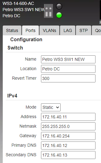

Bug or Feature? We have a default gateway configured on a WS3 but can only access it at layer 2.
