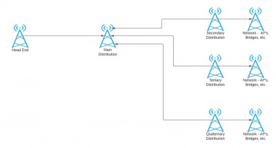

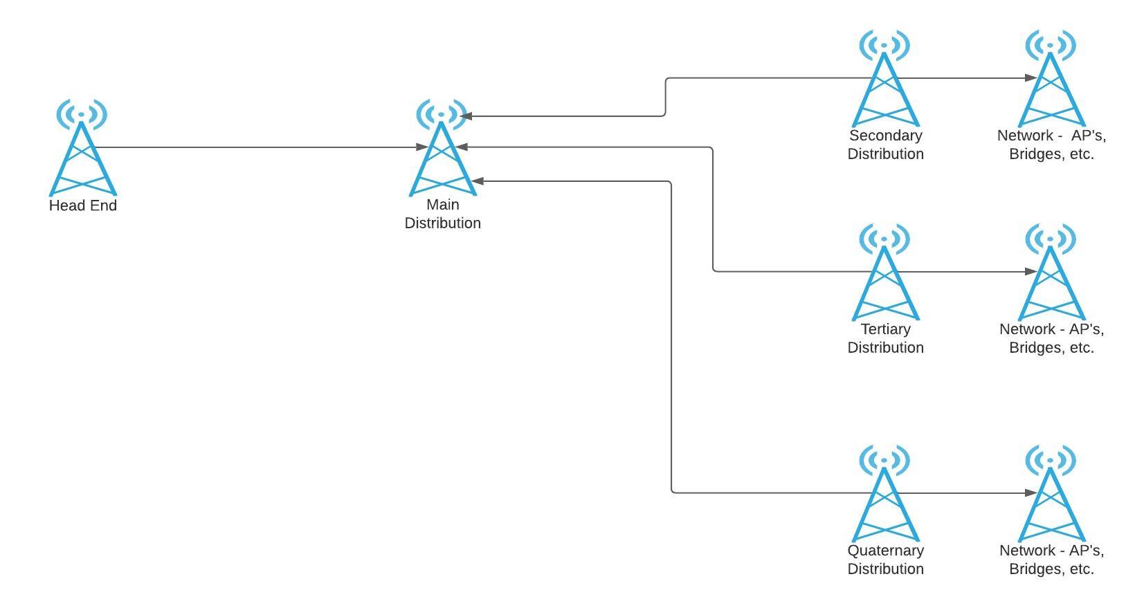

Re: Multiple RSTP links on one switch
Sorry, the best I could come up with quickly.
Hello johnnymac,
I'm a bit confused as to where the trouble is based on the diagram.
If the WS-26 is at the Main Distribution tower, connecting to the Head End, Secondary, Tertiary, and Quarternary tower and assuming there is a different networking device at each of those towers each with different MAC address's and RSTP enabled.
Then connecting the WS-26 with a "discarding" redundant link set by RSTP should work without much more configuration other than simply plugging them in and allowing RSTP to converge.
Although, you did mention VLANs.
A scenario where this might be problematic would be the following:
Netonix Switch| Port 1, VLAN 10 ================ Port 2, VLAN 10 | Networking Device
_______________ | Port 2, VLAN 20 ========x======= Port 3, VLAN 20 |______________________
RSTP is not VLAN aware, so if you have 2 links that are logically separate but physically going to the same 2 devices, such as the above.
Then RSTP will cut the link for one of them.
In that scenario you need MSTP, which is beta, but has matured quite a bit, as you can see on this thread

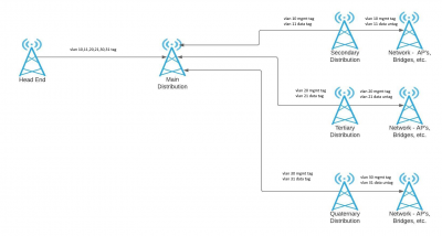

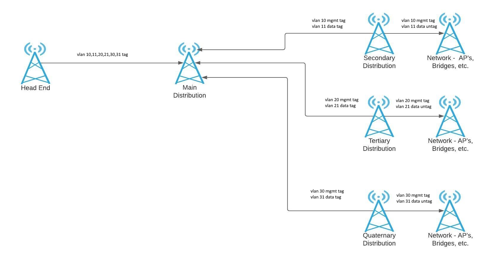

Here a vlan schema. If you can't figure out, the're several consultant on the "WISP talk" group on facebook.
