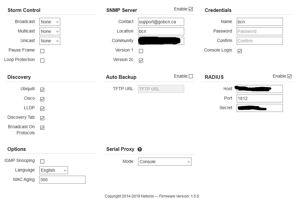

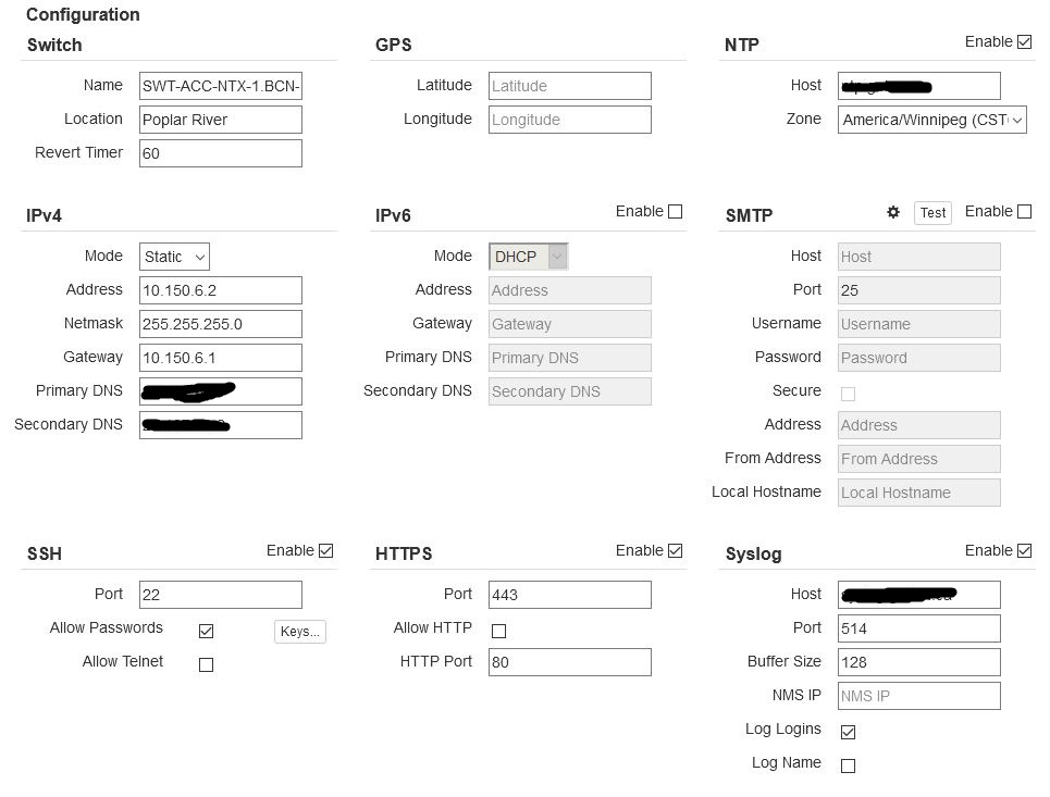

Sure, I'm not exactly what this will illustrate by itself but if it helps:

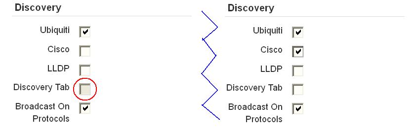

Stephen, while you're looking into this ... This is not directly related to bug described here, but there is also a bug in the matrix of choices under
Device / Configuration / Discovery settings box
that decide whether the "Discovery Tab" checkbox should be grayed out.
Honestly, because of this, I thought the Discovery Tab had been intentionally disabled due to an as yet unresolved bug. For us, we only cared about the "Discovery Tab" for ubiquiti dp. but as you can see from the two captured images, if only ubiquiti is chosen, the box is grayed and does not allow enabling the tab. But if one of the other protocols (eg. Cisco) is checked, both can be enabled and applied. As a matter of fact, one can then come back and uncheck Cisco and apply, and the Discovery Tab will continue to function only for Ubiquiti.
No intention to steal the thunder of the OP, it's just that reading that problem description is what made me realize Ubiquiti WAS supposed to work. :)

JustJoe, that does look like a bug, enabling Ubiquiti should provide you the option to turn on the Discovery Tab. I'll take a look at that.

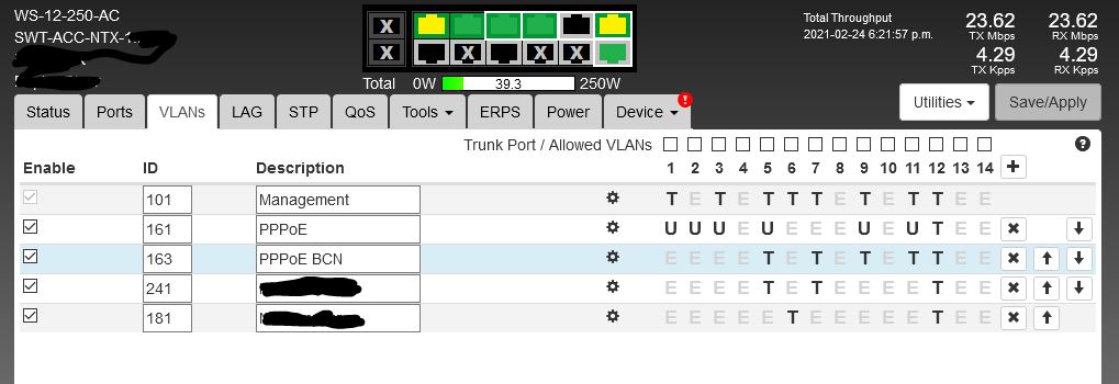

Here is a screenshot from the VLANs tab of the device:
Our management VLAN is 101, that is the VLAN that the switch itself has its management IP on and all of our radios have management IPs on. Port 12 is the uplink to the MikroTik router at the site and CDP and LLDP are enabled on the MikroTik. The ports that have T for 101 and U for 161 have Ubiquiti Rocket 5AC Prism access points connected with current firmware. 161 is the customer traffic VLAN and 101 is the management VLAN. The AP and SU's are all in bridge mode, so they do not have IPs in VLAN 161, only in VLAN 101. This is a standard setup throughout our network and this problem happens everywhere. We have dozens of these things and not one is showing any neighbors.
