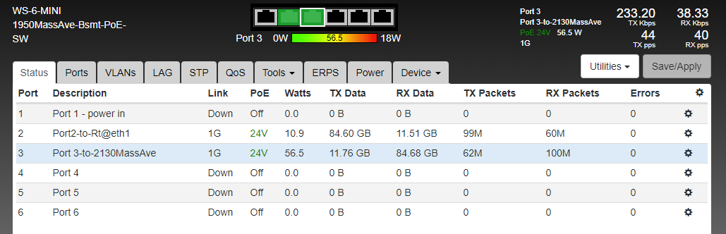

We have a WS-6-Mini that's powered over a 3 ft cable by a Ubiquiti AF24 PoE injector, i.e. 50v and up to 1.2A. It in turn powers a Ubiquiti PBE-5AC radio and a MikroTik RB2011 router. The site was installed 21 months ago and has operated w/o problems until a week ago when we got over-voltage alarms from the mini-switch. The site is still on-line and behaving normally except for the over-voltage indication and an unusually high wattage reported on port 3. I suspect the excess wattage on port 3 is due to fried current sensors. I don't know whether to believe the over-voltage readings or not. If true, at 30.1v the 24v supply is way over-voltage.
The MT router specs say it's good to 30v. But I'm under the impression that >28v would fry a Ubiquiti radio. Unfortunately, ubnt doesn't provide useful specs so I'm relying on on-line discussions.
Since the site is still working in all other regards, it may be a few more days before someone goes to investigate. Is it possible the voltages are ok and only the measurements have failed?
