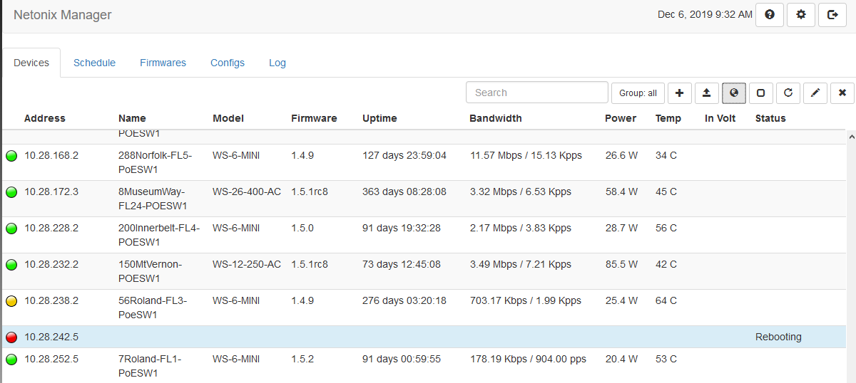

I have one switch (out of several hundred) which shows up red. I can access this switch using https or ssh with no problems either way. I can see nothing different about this switch's configuration except it's firmware. I asked the Manager to update its firmware to 1.5.5 and this worked, i.e. the Manager was able to upgrade the switch, but it still appears red and the Manager still says it's "rebooting" although the switch has come back on-line and is working normally.
What could be wrong?

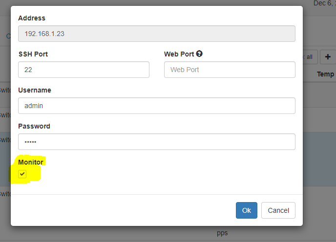

Do you see it connecting and disconnecting in the logs?
Try disabling monitor on that switch and then re-enabling it for that switch.

Deleting the device, disabling monitoring and adding it and then repeating again with monitoring and we're on-line! Thanks>

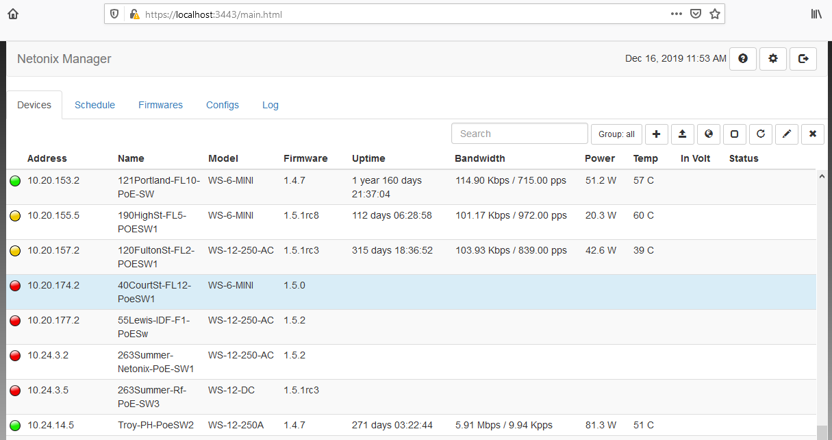

I've been running the Netonix Manager on my Windows desktop machine since last week. When I came in this morning, many of the switches show red. It is possible the VPN from my office to our network went down at some point, but it is up now and has been up for more than 12 hours and yet, some devices are still red.
I know they are reachable as I can log into them from my desktop on a different tab on the same browser.
What am I doing wrong???

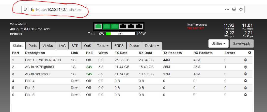

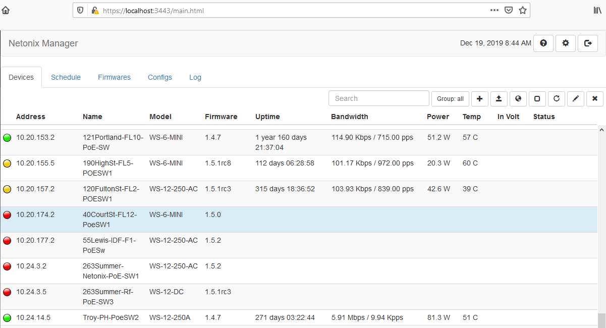

It's now three days since my last post. I went back to look at the Netonix Manager session that is still running on my office desktop system. Despite the fact that my desktop computer has been continuously connected to our network for more than three days, the Netonix Manager has not reconnected with the all of the switches it originally found, i.e. things are as they were in my previous posting - only the date has changed. (See the first screen capture below).

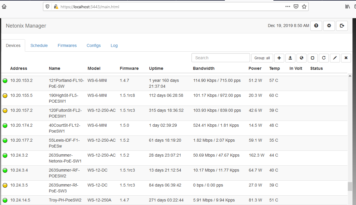

As an experiment, I deleted the first four devices that showed red and then did three scans to try and reacquire those switches, i.e. I scanned 10.20.174.0/24; 10.24.177.0/24 and 10.24.3.0/24. These scans rediscovered the four formerly red switches plus one more switch than apparently wasn't discovered by my original scans more than a week ago. See screen capture 2 below.
So my Netonix Manager is still running but it lost access to 82 switches, four of which I've just restored. I will now delete the other 78 switches that are showing red and re-scan the five address blocks needed to rediscover those 78 switches. But how long will the Manager remain connected to all switches?
