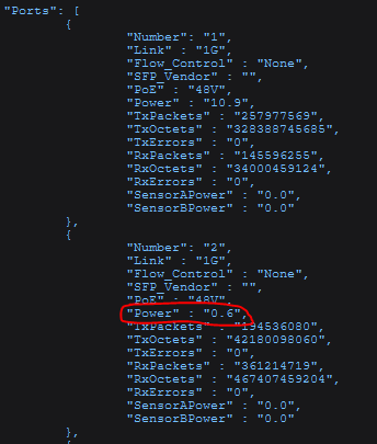

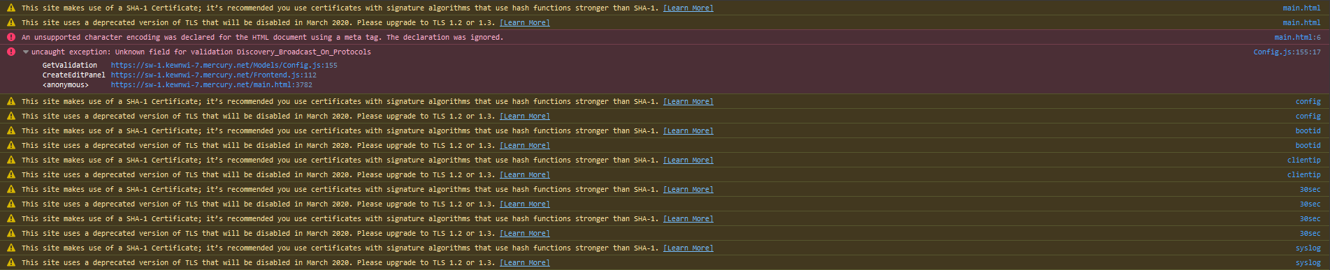

Issue 2
Attached the dev console and JSON screenshot. This wattage display issue only is on one port which is port 2. This does not occur on every port, and it does not follow the device when it is plugged into another port.
Issue 2
- Posts: 1077
- Been thanked: 208 times
Re: v1.5.5rcX Bug Reports and Comments
Ahh, it's working on my WS-12-250-DC on that port, so it must be a bad port sensor. My suggestion is to RMA the unit.
