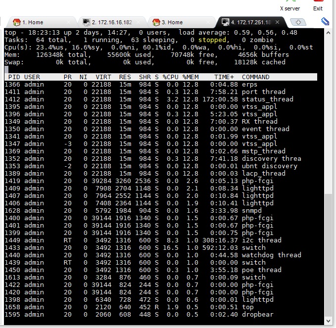

Stephen wrote:We've been trying to track this one down for awhile. I have a few questions that will help us isolate it for your situation. Do you have any SFP module's inserted? Are you using Discovery at all? Do you use SNMP in anyway? Did you notice a difference in the rate of memory loss when upgrading to 1.5.4?
Hi,
Do you have any SFP module's inserted? - Yes we do
Are you using Discovery at all? - Yes we do
Do you use SNMP in anyway? - Yes we do
Did you notice a difference in the rate of memory loss when upgrading to 1.5.4? - The rate of loss looks more or less the same.
Check the TOP stats we have gathered.
yesterday 15:55 GMT+2
Today 18:28 GMT +2

If possible everyone try turning off SNMP to start with and restarting the switch to see if that helps. Right now I just need to isolate where this is coming from.

I have disabled snmp monitoring and snmp on the switch itself. I will give you some stats tomorrow.
