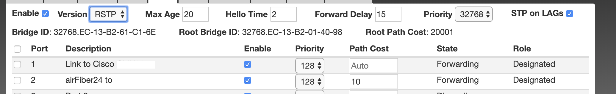

Please a picture of the STP tab for at least one of the switches.

Here you go,

What I'm thinking right now is that maybe the root is bouncing around a few time's which causes the delay. So possibly changing the priority on the root to solidify it's position so that when the link goes down and up again it is obviously a much higher priority might help. But I'm still trying to prove that in my own setup.
