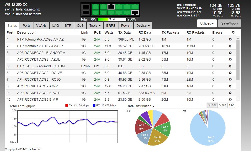

So to clarify some facts:
- the switch is not rebooting correct?
- the radios are rebooting or disconnecting?
Can you post up a screen grab of the following TABs:
Status
Power
Device/Status
Status
Power
Device/Status

Re: WS-12-250-DC at Solar tower issues
Hi,
- The switch is not rebooting since we connected it directly to the batts.
- The radios are all rebooting at the same time.
Status, power and devis status attached
Thanks!
Thanks!
