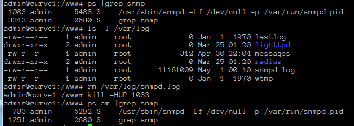

Also, to be safe, there should be no severe consequence if you remove that log file, it will just re-create it when it needs it:
Code: Select all
rm /var/log/snmpd.log
Ludvik

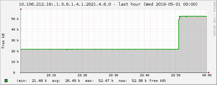

It was not re-created after deleting the log file. I tried "kill -HUP" and hoped to reload the configuration and create a log file.
But the process was killed ... and after a few seconds started: Apr 30 23:49:30 monitor: restarting snmpd
However, I was very surprised at the status of RAM occupation. Instead of 106MB, now only 74!
I myself wonder what will eventually be a mistake. Later I try it on another switch.

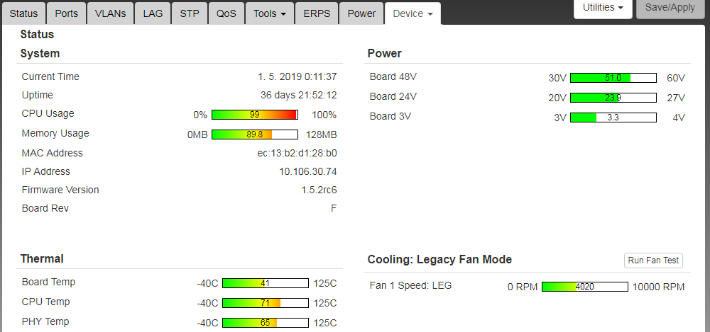

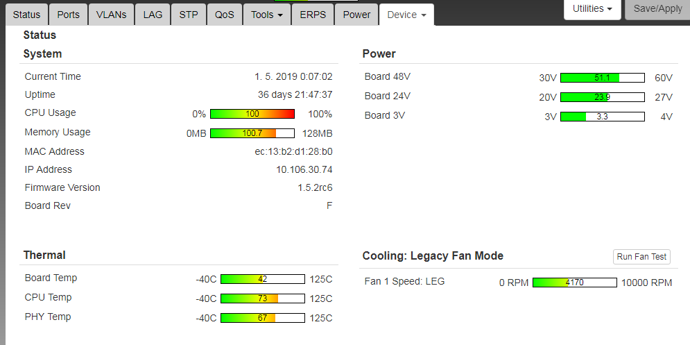

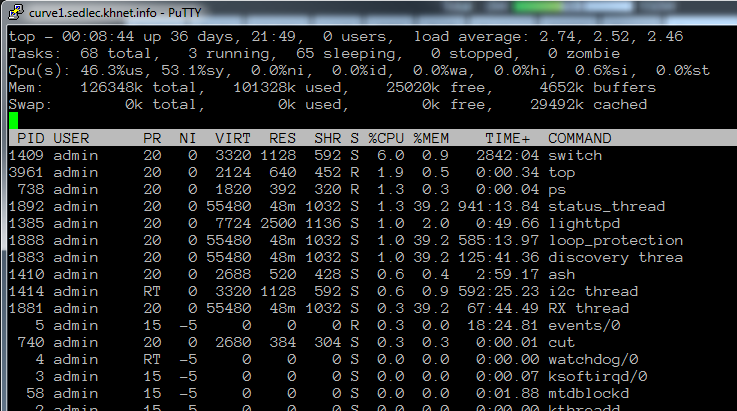

Test on 10.106.30.74
The CPU usage is strange. I didn't do anything, just checked the log file and got the WEB-GUI open. I would like the htop program to be part of the firmware.
At this state i remove log file and reload snmpd.
Result:
