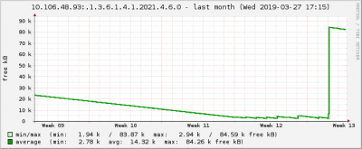

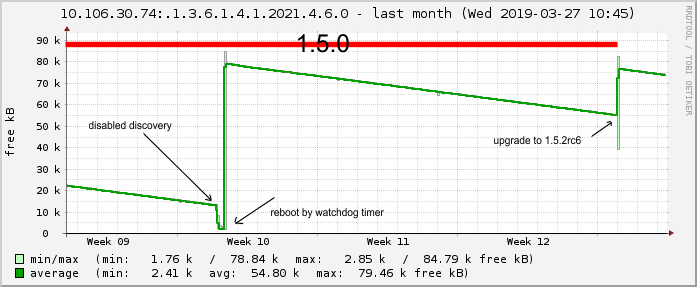

It is inevitable that there will be some increase in memory when discovery is active because discoverable device details are stored in memory and dumped to a file at regular intervals. So some increase is not avoidable. However, in my own tests, I had >1000 emulated discoverable devices and the memory went to about 65-70MB and stayed there, which was acceptable. I can see though that at least in one instance on your graph the memory reached max which is of course not acceptable - however, to be certain, on your second image on the first (and only) memory increase to 0 free Kb, was that before or after the upgrade?

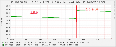

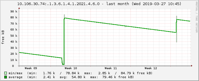

Re: Memory usage
Upgrade from 1.5.0 to 1.5.2rc6 is vertical line on monday (midnight).
The vertical lines at week 10 is two steps - disabled discovery and then restarting by watchdog.
In discovery tab is 36 devices.

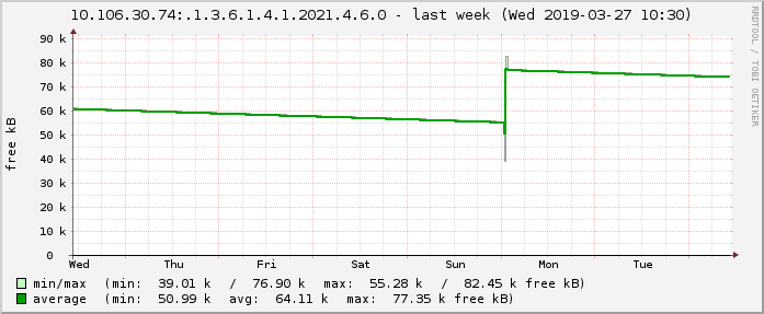

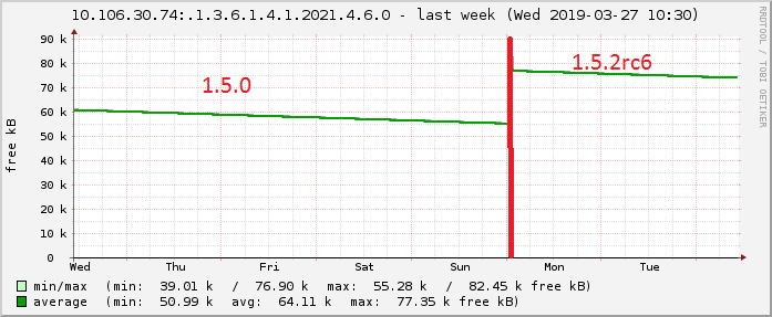

- Posts: 1077
- Been thanked: 208 times
Re: Memory usage
Oh I see, so the first image when the memory drops, it is because of the upgrade to the rc6 release.
On the second image it was still on 1.5.0
So is this an accurate interpretation?
If so, and I am reading your graph correctly, then it means that the current memory usage is around 50-55MB?
If that is the case then it is still within tolerance. There are many different service's running that cause memory to fluctuate. If it goes above 80MB (or from your NMS point of view, if the memory free goes to less than 48 MB ) Then we still might be looking at a leak.
A few of the live switches we have been testing on have been resting at about 52-58MB for over a week and have not fluctuated after getting to that point.
One other thing, 1.5.2 is out, you can update to that if you want to get a few other feature's that have been worked on and continue the test from there if you'd like.
However, the memory management architecture for discovery hasn't changed from rc6 to the release so if you prefer to just let it run as is for this test then it is OK.
(But for all the latest fixes/features for everything else I would recommend going to 1.5.2)

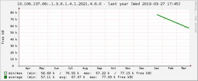

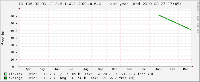

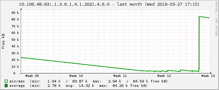

Re: Memory usage
It's same graphs of free RAM, difference is time axis.
Current memory usage is relatively OK ... but grow in time still. This is not one case. That's how all my netonix switches look like. The difference is in the curve angle. But it always points to zero.
Another example:
How exactly do you test discovery? MAC:IP one to one? In my network usually UBNT is in bridge mode and behind it is either a tplink router or a mikrotik - ie discovery twice with the same MAC.
Another example:

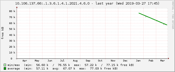

Re: Memory usage
Well I then rolled out to a tower which has a couple hundred devices, all be it a routed tower with VLANs for each AP.
But to be honest I never had any of this memory issue with older firmware which you can see in this post: viewtopic.php?f=17&t=4788&start=10#p28147

Re: Memory usage
You are lucky man ... I'm not ...
Yes - memory usage grows sometimes slowly and it is no problem after years. But sometimes is problem after few months - switch rebooted by watchdog. And your software problem is my problem, users hate me.
