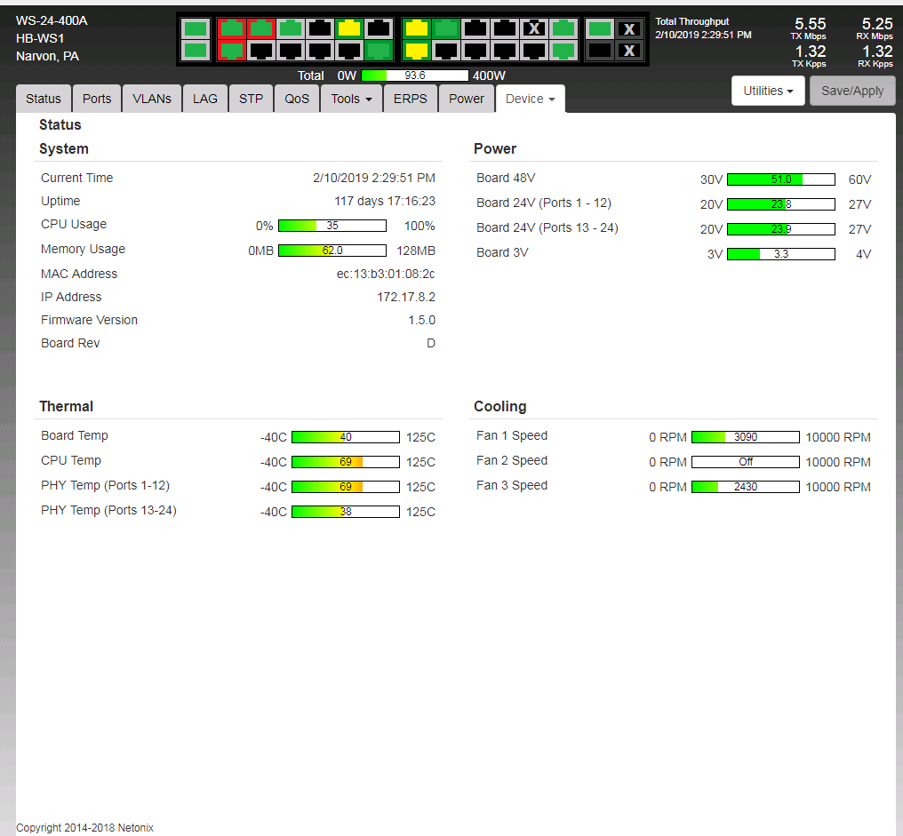

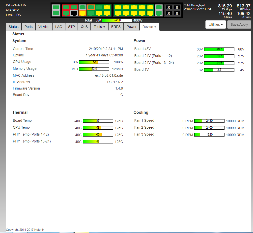

I am running v1.5.0 and v1.5.1rc11 and I am not seeing this memory growth issue.
There is no way we can address your issue without knowing the cause.
You need to make a way we can access one of these switches or put a switch on your network, set it up the same but does nothing real. Then verify you are seeing this memory growth and make that switch accessible to us.

No, memory leak is not proven.
60,000 switches in service and only 5 people have reported an issue.
So there is some condition that causes this and we have no idea what it is.
Post up screen grabs of all your TAB (complete TAB)
