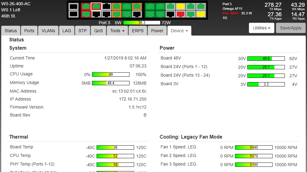

CPU and memory usage look ok.

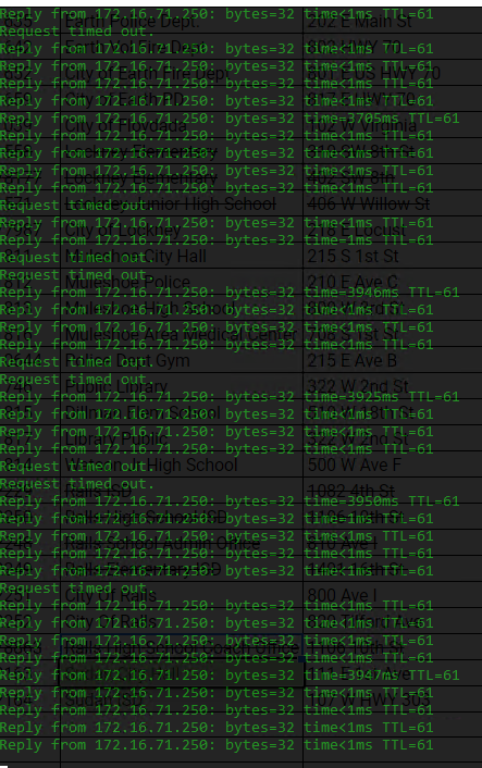

This is what the switch looks like when you ping it's IP.
WS26 with Bad Management
