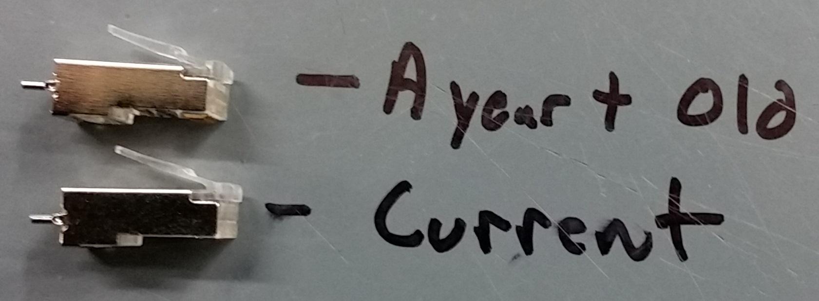

In the picture below are 2 ENDS
The one END I just went and retrieved from my EMERGENCY tower backpack for when I am on call and I stocked those ends over a year ago.
The other END if from current stock I just got out of a NEW box in warehouse.
I do not see any differnce in them?
CLICK IMAGE TO VIEW FULL SIZE

Do either of those ends have numbers on the tab?
I had some older ends that did not have numbers and they fit fine. What I believe are a newer batch, or at least a newer order for us, have numbers on the tabs, and they do not lock in to those radios. They will lock in to other devices though.

Neither have numbers on the TAB/TANG
And the newest one i pulled is from the latest batch we have in the warehouse and the one from my emergency truck backpack is from over a year ago?

Got at least a whole box full of numbered ones. The sizing issue is the tab itself. The distance from the face of the tab,to the top of the latch is greater. Combined with some extra plastic on the radios connector in that area,and they cant click.. its hard to see with a picture.. but u can see it

So after further discussion with factory in China this is what I found out.
All our END's ordered prior to the last shipment had the number on the tang.
The last shipment was the only order with the ends without the number on the tang.
So the factory that installs the ESD shield on the RJ45 ENDs changed suppliers of the RJ45 plastic ends for that order as the other plastic ENDs were in short supply.
So the ENDs in my emergency bag must NOT have been a year old as I thought, maybe one of my guys changed them out as I have them update config files and such in the emergency bag periodically.
The factory says both ends are certified to work in standard RJ45 jacks, do not get me wrong I am not saying you are not having issue with that one Cambium radio you probably are.
UBNT had used a RJ45 jack in several runs of the AFX radios that did not like some ends and the cables would come out. And our OLD WS-8-250-AC which is now EOL also had RJ45 jacks that did not like some ESD ends.
So our current inventory in warehouse are ENDs without the number on the tang but the new order which is on the sea right now does have the numbers on the tang again.
I need to hunt around and find a box of ends with the number on the tang and order in some radios then do some testing to see which END's work best all around. That way I can order those END's in the future.
