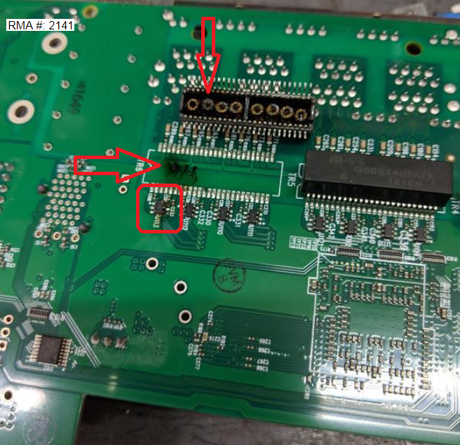

Re: WS-12-250-DC - only fan and power led on.
Hello sirhc, thank you very much for the reply.
I attach pictures of the board. Please let me know if you need a better picture.
I wonder, this switch is power supplied by batteries, which are charged by a solar regultor, which I think may be the origin of the problem. Is there any way I could protect the switch from this? The netonix then blew a PB400, is there any way I could protect whatever is connected to the switch?
Thanks again!
Luciano
Thanks again!
Luciano
1) Did you hook up a console cable like I asked and see if the switch is outputting anything?
2) You're going to have to REMOVE the switch board from the chassis and take good CLEAR pictures with plenty of light so I can zoom in and see details. You need to take picture of top and bottom of board. Take note to where each cable goes so you can put back together. Maybe take pictures of all cables before you take apart.
As I said my guess is the switch was damaged from ground current. Did you read the grounding posts I linked you above?
People incorrectly think ground is ground and this is not the case. A ground potential difference is a LOT of current and can fry equipment. YOU MUST BOND TOWER GROUND RODS WITH ELECTRICAL SERVICE GROUND RODS - READ ABOVE POST LINKS ABOVE.
I also linked above some modification you can do to make your switches better deal with ground current from poor grounding.
My guess is ground current took out the switch and the one radio that was the path that the ground current took.
You can RMA just the switchboard or boards and send in a small box via Postal Mail. If the boards are damaged we will fix if possible for a small fee or replace them at cost and ship them back via postal mail in a small box.
Your pictures are a little dark and I can not see clearly but is this component damaged?
If this is damaged and you have no serial console port output then most likely your board is damaged beyond reasonable repair but we can sell you a replacement board.
As I said make sure your read grounding posts above and properly bind tower ground rods to service ground rods:
Same thing happened to me today. Went up to site, only power light and fan at full speed. Replaced it with the same model. I went back to the bench with it, tried reset, and hard reset, no go. It only had one input from router and 4 poe 24V sectors on it. I have two other 12-250's working, and two AC's working. First time this has happened, but if it happens again, and we don't know why, we are going back to toughswitches. Any thoughts?
Best,
Phil
Can I remove warranty sticker to look at board? It's less than a month old.
Best,
Phil
Groong wrote:Same thing happened to me today. Went up to site, only power light and fan at full speed. Replaced it with the same model. I went back to the bench with it, tried reset, and hard reset, no go. It only had one input from router and 4 poe 24V sectors on it. I have two other 12-250's working, and two AC's working. First time this has happened, but if it happens again, and we don't know why, we are going back to toughswitches. Any thoughts?
Best,
Phil
I do not see how it is less than a month old since we stopped putting those decals on almost a year ago.
Go ahead but if it is ground current or shorted cable damage you may not see the damage without removing components fist.
I would RMA the unit as we provide detail report with pictures of what we find.
If it was a failure we repair and return for free but if we find damage there is a repair fee.
Our damage reports most often include pictures especially if the unit is within warranty period.
On older units way out of warranty we do not always include pictures to save time as it is out of warranty anyway but we explain what we found and how to correct it from happening again.
If your unit did suffer ground current shift damage it will occur again unless you fix it. Ground current shifts occur from rain, insufficient grounding rod potential, or from neighboring sites as all services in the immediate area are all bonded together via the electrical company as ground is bonded to neutral in all panels and they hand you HOT, NEUTRAL, AND GROUND

viewtopic.php?f=30&t=1429
Read the posts above but the basics are as follow:
Tower ground rods must be bonded to electrical service ground rods HEAVY #2 wire.
We will RMA the unit. It was purchased via Amazon. Possibly the seller had it in stock for that long? I'm just the installer, I'll bring the unit back to the boss who purchased it and he'll return the unit this week most likely.
Thanks.
P.
Here are pics of new unit, just arrived yesterday:
Thanks.
P.
10 posts
