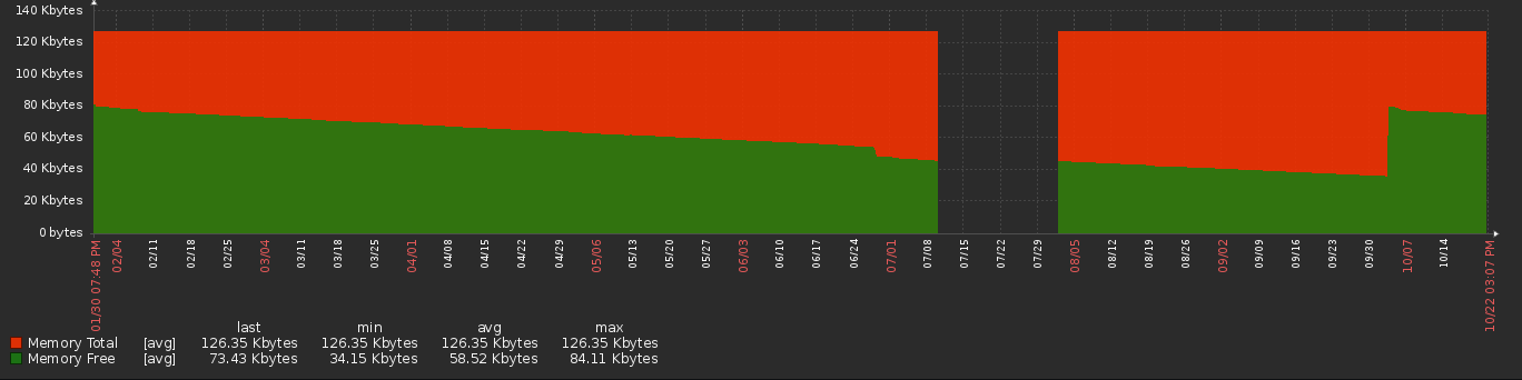

I haven't found this reported on the forms for the 1.4.9 firmware, but I believe there is a memory leak somewhere.
I've got a few WS-12-250-DCs across my network and I'm seeing the free memory all both of them slowly drop over the period of about 10 months.

I'm showing memory leaks in 1.5.0. One device that's been up 111 days. Originally had 38% memory in-use post-reboot, now 51%. It's slowly trending up for sure.

Eric did say memory will grow a bit over time as the switch uses it for stuff (technical terminology) but there is no memory leak that will cause a problem. We had a real memory leak that did cause an issue many versions ago but was fixed.
