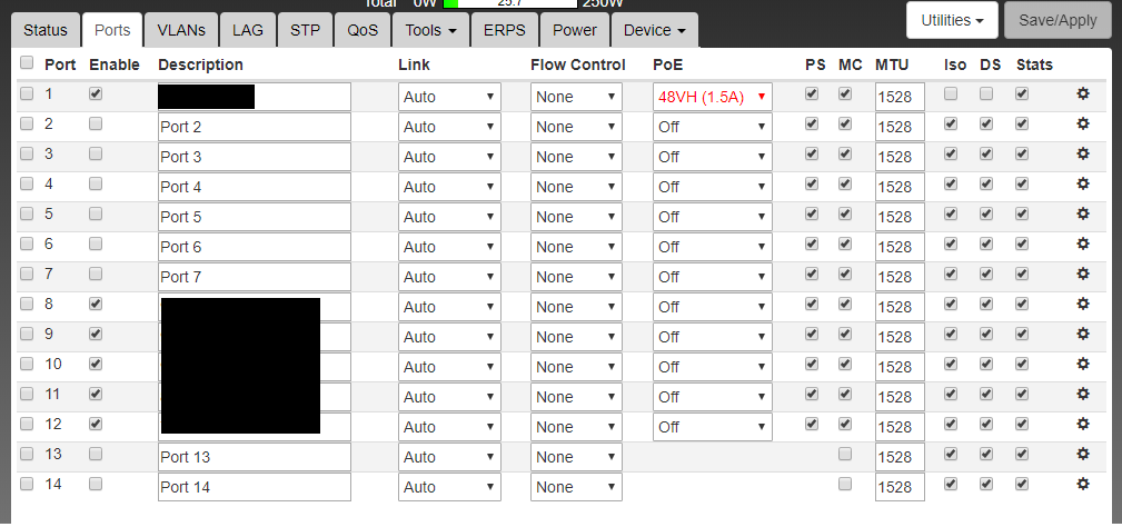

Re: Possible bug with Port Enable?
Here is what the Ports tab looks like. Other than configuring the SNMP/Password settings there's not much else we do to these other than the VLANs.
Would a picture of a different tab or the config itself help?
It's actually pretty easy to see the issue. When we first enable a "new" port that's been disabled but part of a non default VLAN, and then check the MAC Table it shows that it's reporting the MAC on vlan 1, when it's not even configured for VLAN1 rather vlan 2xx. If I go to the VLAN tab, edit the VLAN to be default, save it, then switch it back all better. This is something we can re-produce on the 12 port AC, and the 6 port Mini. It's with isolation turned on for the port. I've not tested with Isolation off. But it's really clear that something isn't working as intended when you see the MAC for the port on the WRONG vlan in the MAC table, then check the VLAN table and note it's not even configured to use that VLAN.
