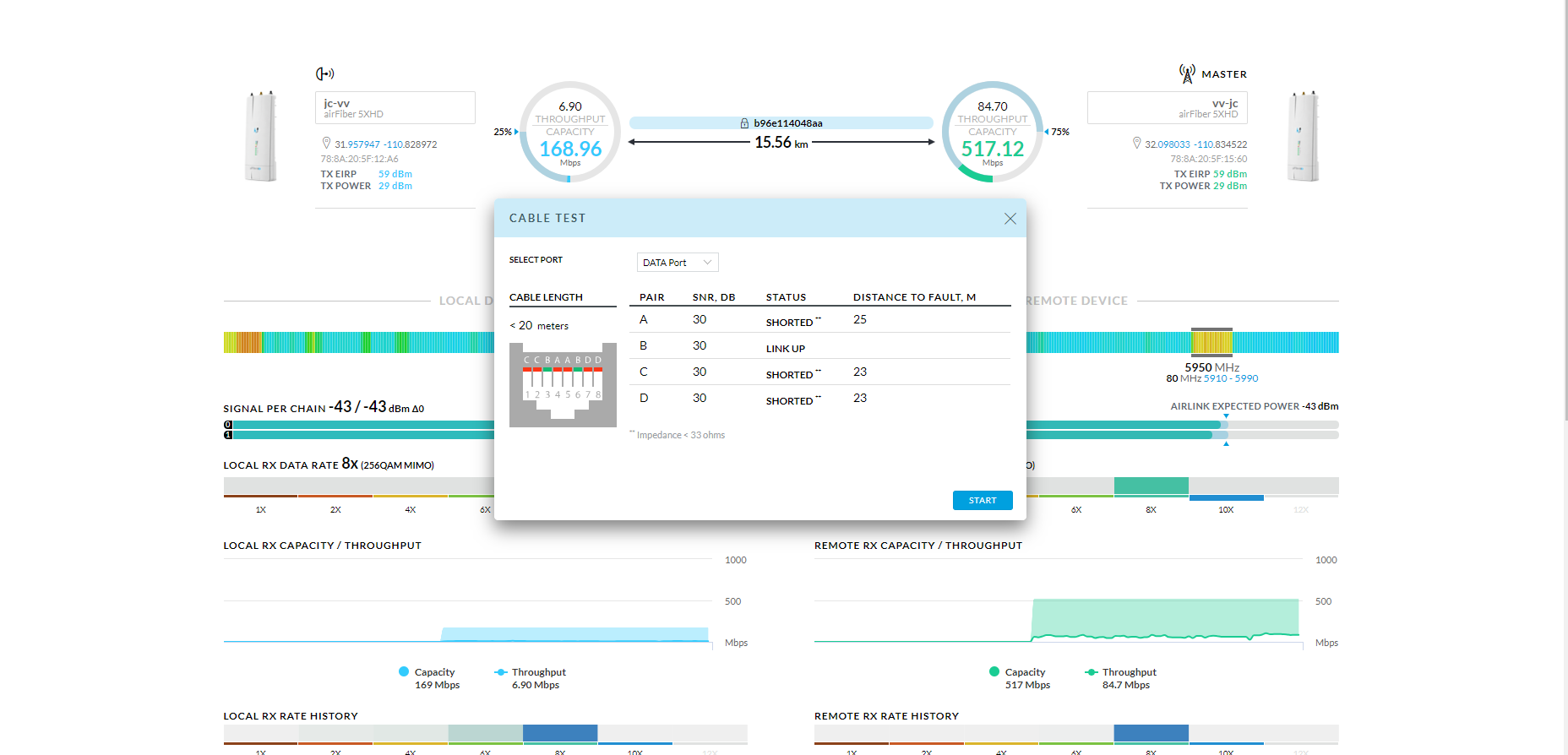

Put up a screen grab of the cable diagnostics before you power it up and after you power it up.

Here is a screen grab of the equipment while power on we will need a tech to go on site to see what the cable test shows when powered down.
