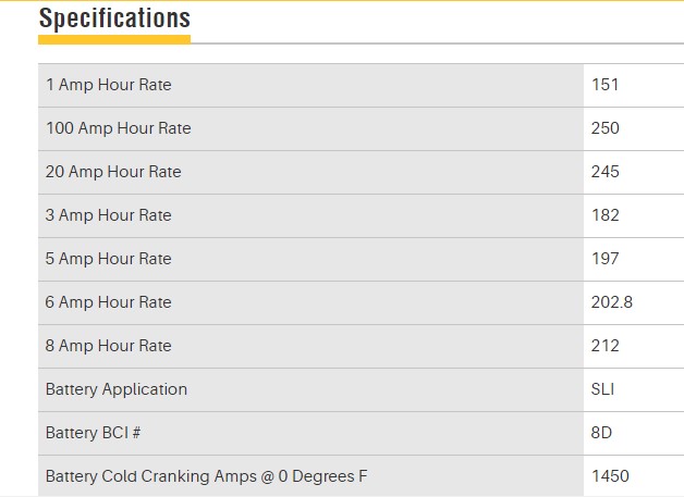

As a point of comparison, here is a horking big battery that costs around $1200 as compared to my $200 battery.
https://www.napacanada.com/en/p/NAB8A8DT716
