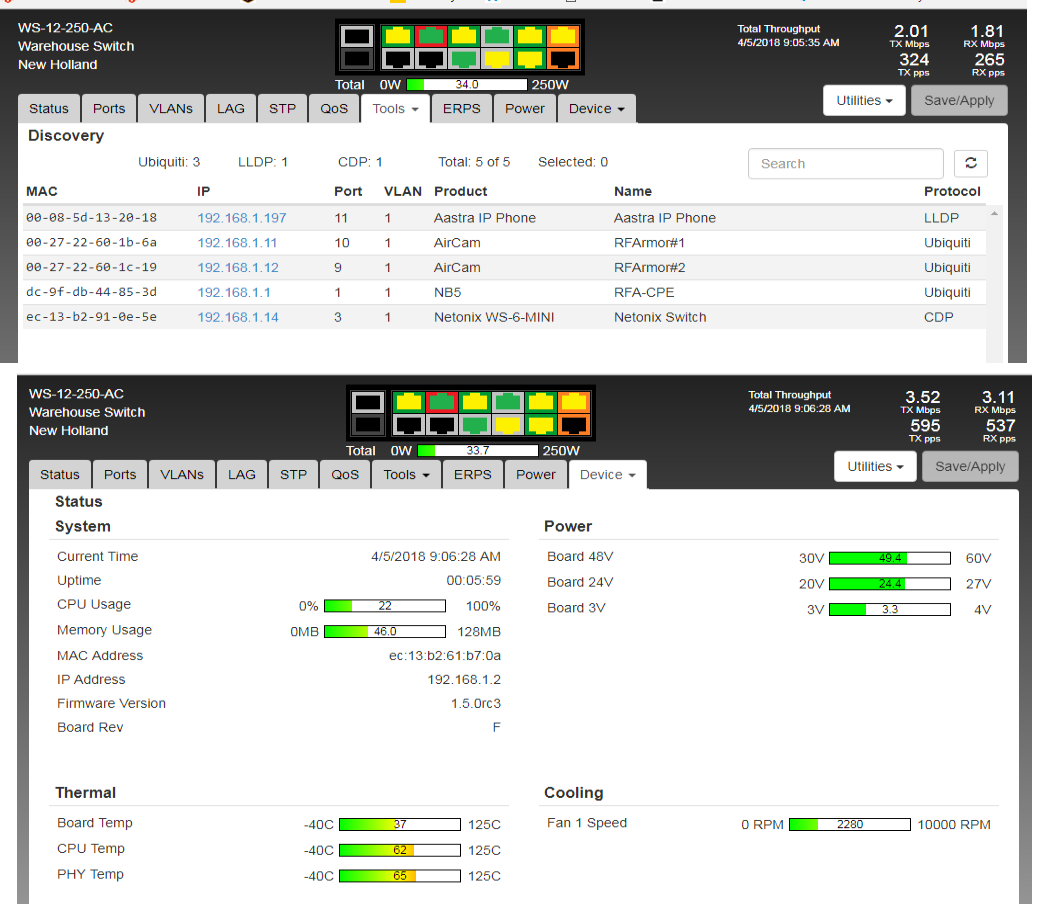

I just tested v1.5.0rc3 Discovery TAB and it works for me?
Mind you this is in our warehouse so there is not many devices to discover.

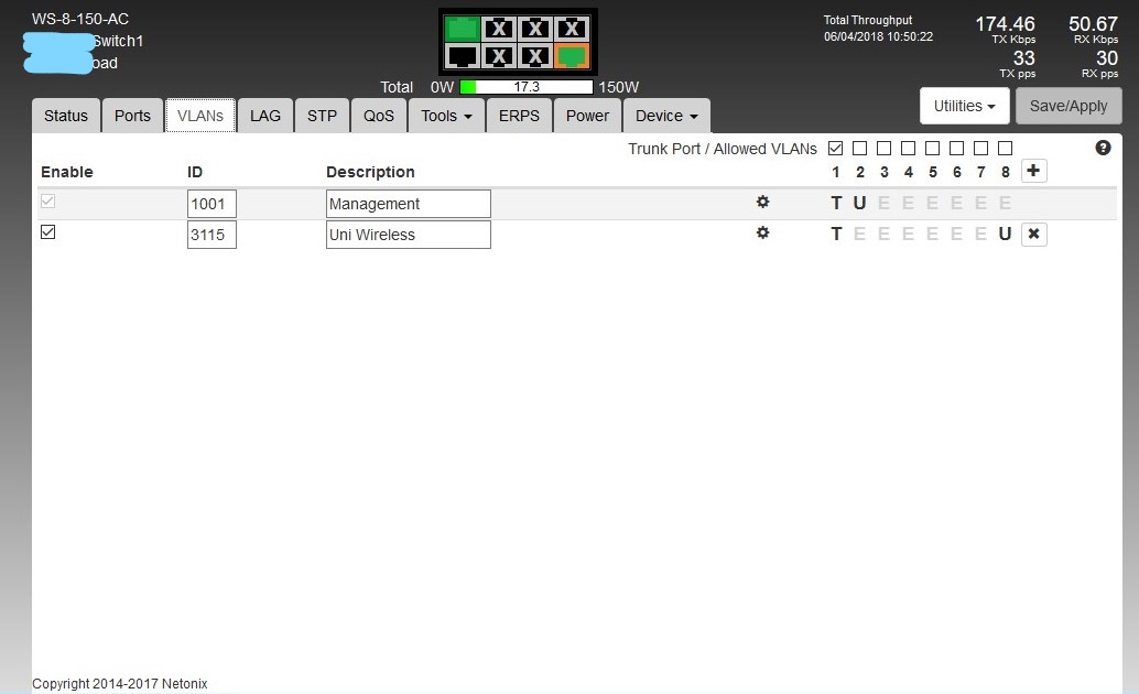

In the meantime Post up the following config TABs:
Device/Status
VLANs
Device/Config (requires a little work to get the whole page in a picture, use print screen and paint to make it whole)
Device/Status
Can you test on another spare switch in your office with no major config changes from default and see if Discovery picks up an Aruba in your office?

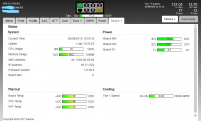

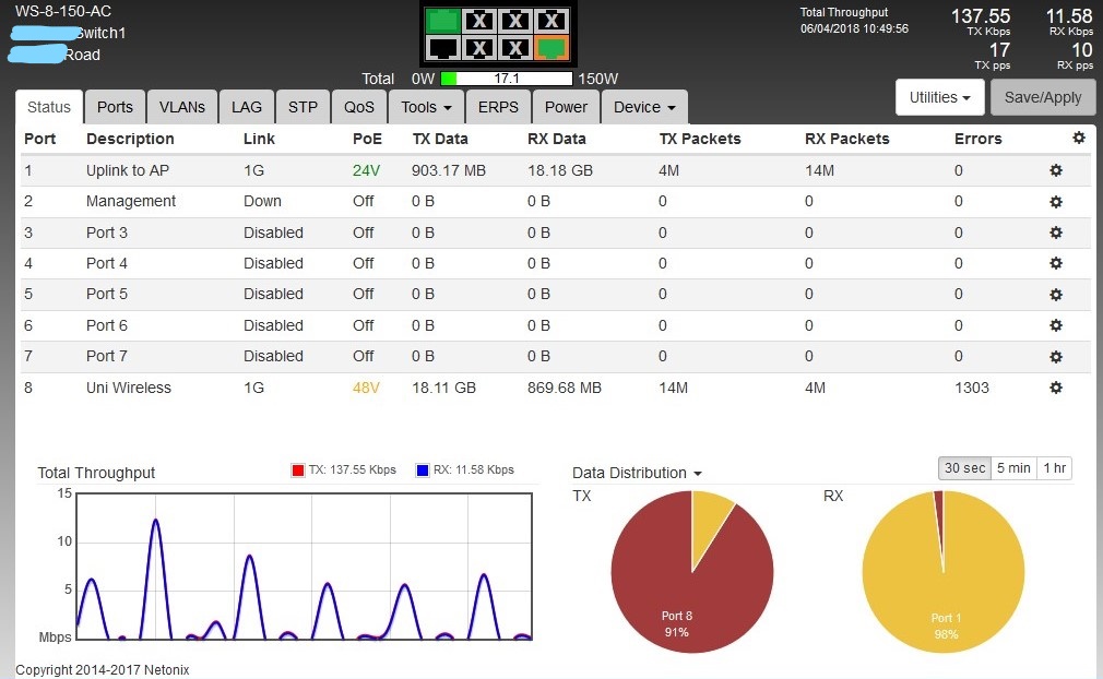

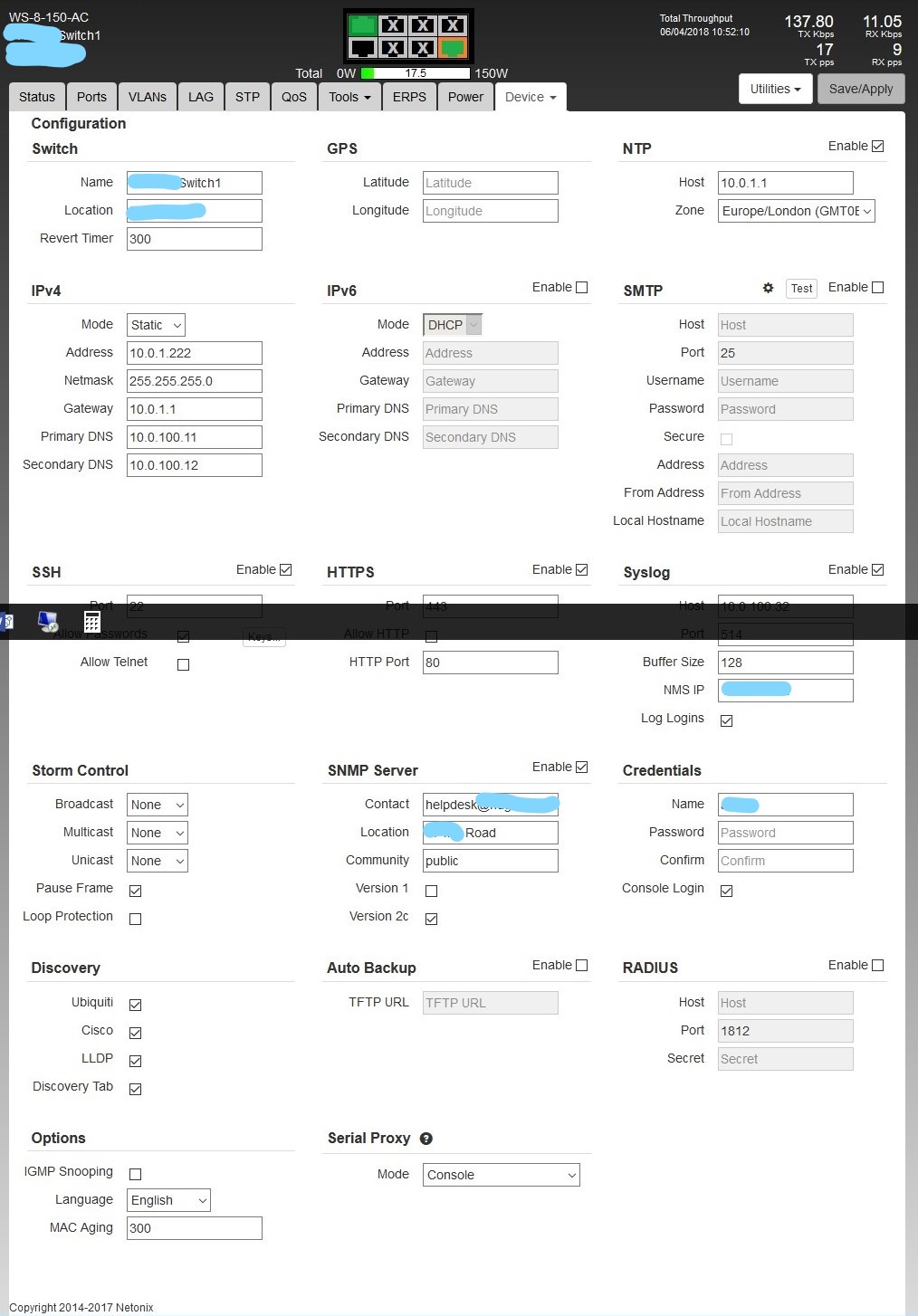

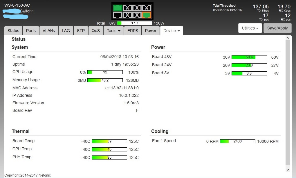

Here's the tabs required. I can confirm that none of the 15 WS-8-150-AC I have will show any devices connected.

HughesHall - I believe this his has to do with your VLAN configuration?

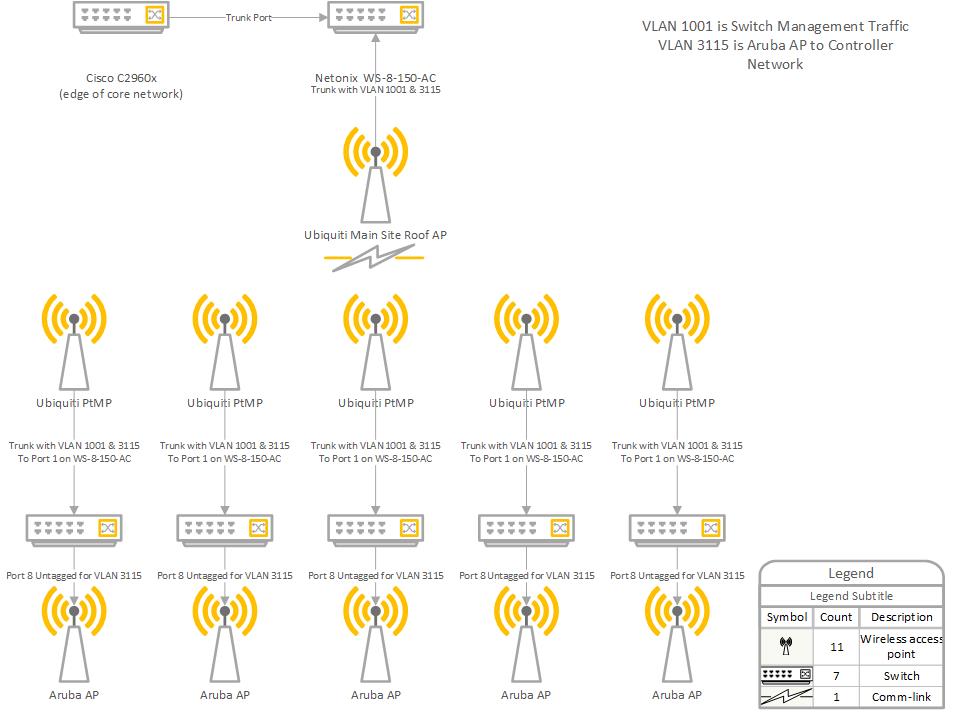

Please make a network diagram of this layer 2 segment and provide some more detailed descriptions of your VLANs and how they work in this Layer 2 segment.
- HughesHall
- Posts: 8
- Joined: Thu Feb 15, 2018 6:01 am
Re: Discovery TAB Issue
Here's a basic diagram. I'm sure there will be more questions
It all works in terms device communications, all the switches and Ubiquiti AP's are managed with the Cisco core switches on LAN 1001.
VLAN 3115 makes a L2 link back to the Aruba controllers for all the Aruba AP, No other interaction with any other VLAN.

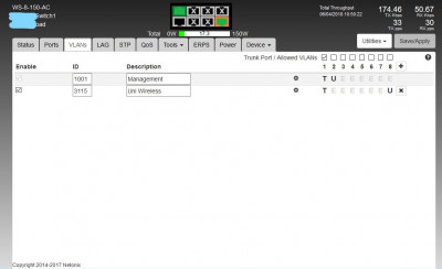

Can you posts a picture of the POP UP menu where you configure the Trunk Port / Allowed VLANs.
