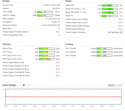

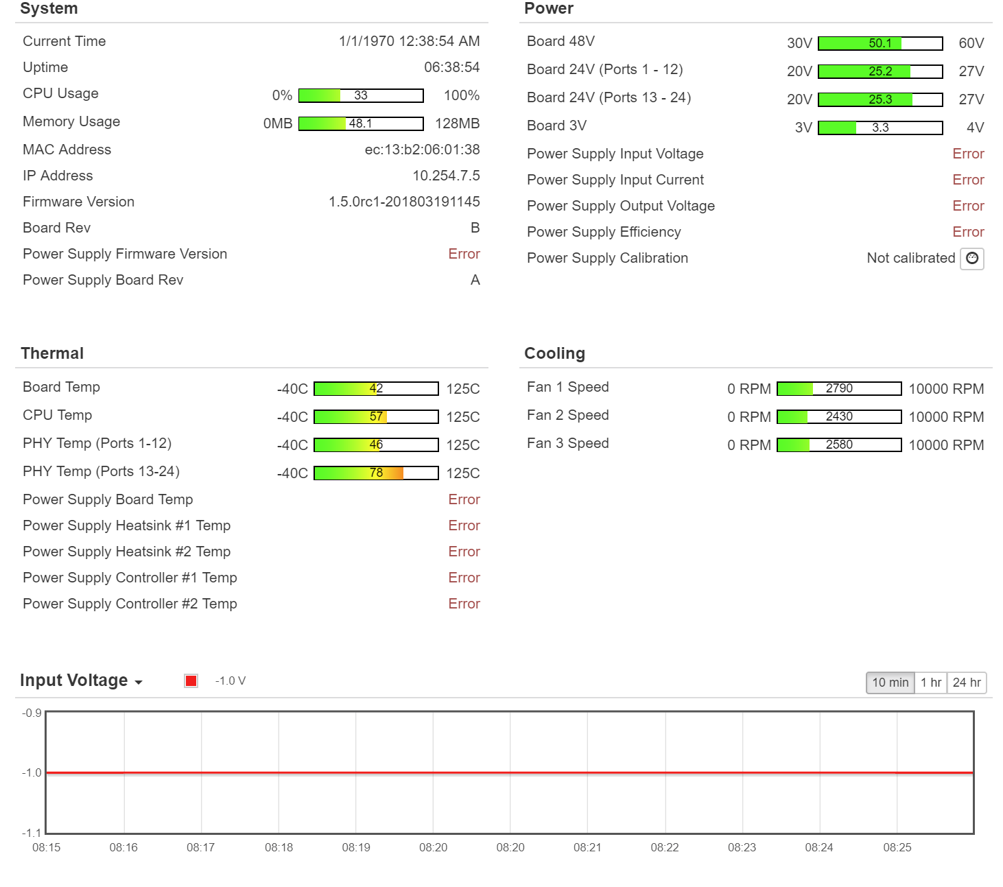

Here is something new on one of the switches updated to 1.5x

We have updated 5 out of 6 units to 1.5, we are not able to take the other unit down currently requires advanced notice for the specific customers.
Mat
Re: WS-26-500-DC intermittent power issues??
intellipop wrote:Here is something new on one of the switches updated to 1.5x
Can you reboot that switch?
Sometimes this does happen on rare occasions (like 1 in 1000), a reboot fixes it most times but sometimes requires a power cycle.
So read this post and the one below it:
viewtopic.php?f=17&t=3605&start=20#p23459
Basically v1.5.0rc2 caused unforeseen issues.
We pulled v1.5.0rc2 down and are testing v1.5.0rc3 all day today and tomorrow and hope to release it soon
My suggestion to you is pull the switch out of service for now.
Bring back to office
Fix the I2C cable as described in this post: viewtopic.php?f=6&t=3621#p23402
And wait for v1.5.0rc3 which we hope to release soon.
We are very sorry for this issue and we are working hard and FULLY testing v1.5.0r3 to make sure it fixes this.
- ALXMADRID
- Posts: 5
- Joined: Wed Aug 24, 2016 2:24 pm
Thank you for the quick reply. We will try the cable fix.
ALXMADRID wrote:Thank you for the quick reply. We will try the cable fix.
Also please if you can pull that unit from service.
We will have a firmware release soon but I want that upgrade to occur in your office under controlled environment.
It is possible that v1.5.0rc2 would have caused an issue that will require the unit to RMA.
I will be making a post explaining all this when v1.5.0rc3 is released.
