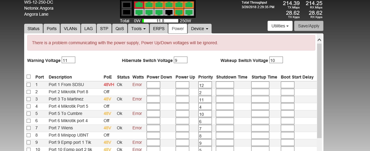

Anyone seen this issue I get errors all across the board I tried a reboot and a firmware upgrade to latest version all same thing. I have not tried a hard power cycle yet? 24 volt DC system nothing changed in the last 200 + days?? Only reason we saw this was because our backhaul rebooted due to power reset. logged into netonix and we saw these errors??
EDIT HARD power cycle fixed the issue??? I also notice before the power cycle the fan RPM was around 8850 rpm its now down to hardly running. The switch was not even hot it was cool to the touch before the power cycle RPM now down to 2550

Accel Wireless wrote:EDIT HARD power cycle fixed the issue??? I also notice before the power cycle the fan RPM was around 8850 rpm its now down to hardly running. The switch was not even hot it was cool to the touch before the power cycle RPM now down to 2550
Odd, sometimes shit just needs rebooted, it happens.
I hope your running at least v1.4.9 but I would suggest v1.5.0rc1 which was released with some important/good improvements.

Re: Wisp Switch cant communitcate with power supply??
Yeah power cycle fixed it agree sometimes shit needs to be rebooted. It's nice how these things work so well but you never expect something to fail or glitch but such as life, still VERY HAPPY with these switches!!I upgraded to 1.4.9
