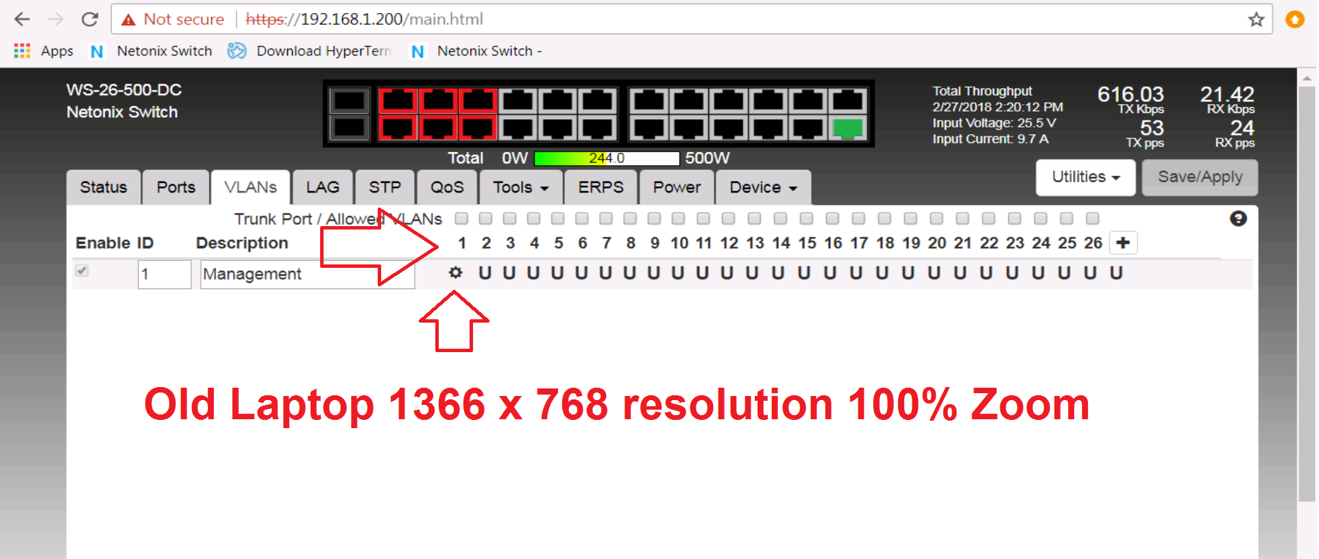

jakestevens19 wrote:I'm using chrome but this laptop has a pretty large screen. I guess that solves that issue though if I just go to 80%.
I just looked at our OLD laptop we use to serialize and it messes up there too at more than 80% zoom
I did ask the programmers to look into it.

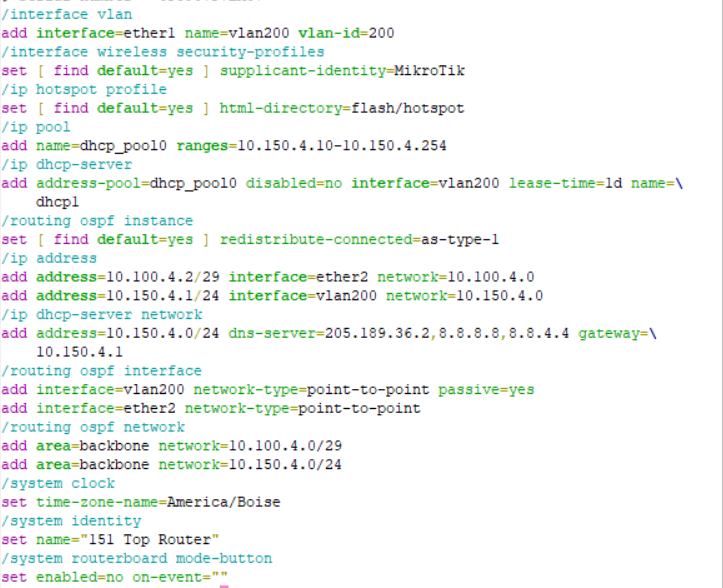

Attached is the config I am working with. The router is in port 14 and I am attempting to pass traffic over VLAN 200 to a mikrotik AP that is on port 9. Please let me know what I am missing in the Netonix config. Thank you
switch config
router config

OK, this is not a question about the switch UI or how to use the switch but rather about how to use VLANs.
We follow the 802.1Q "Standard" which means VLANs work the same on our switch as any other switch.
If your router is on port 14 and the router is setup to send packets to the switch encapsulated with a VLAN ID of 200 then Port 14 on VLAN 200 needs to be a "T" which means that packets that will be accepted for ingress on port 14 from the router will be encapsulated and have a VLAN ID Tag of 200.
Since you have a "U" on port 14 on VLAN ID 200 you are telling the switch to only accept UnTagged or Unencapsulated packets.
You really need to read about 802.1Q VLANs and how to use them and how they work.
