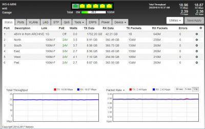

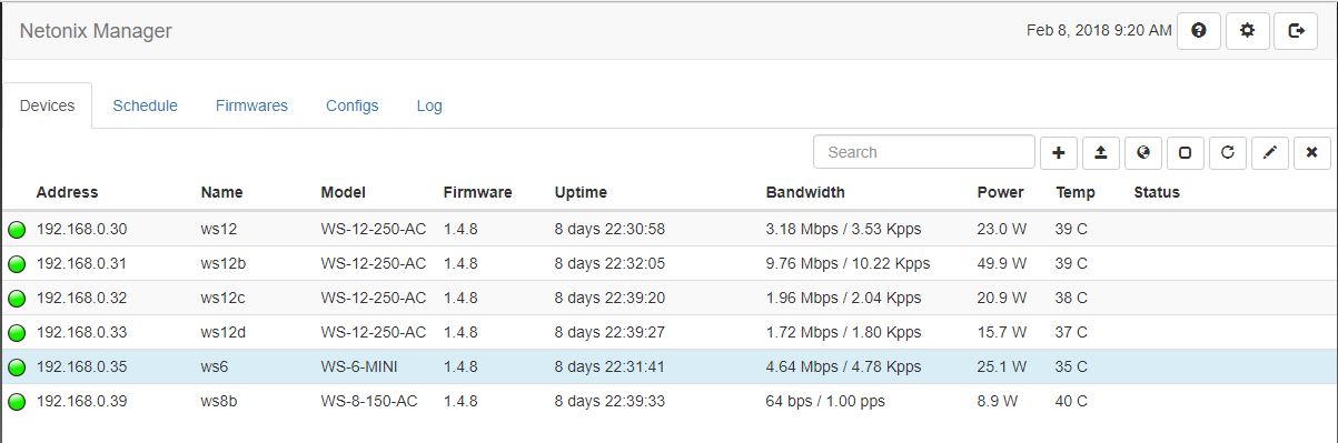

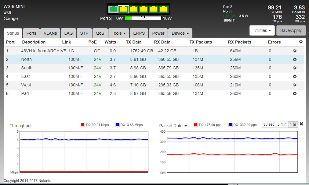

Revisiting this from Nov 2016.
Installed v1.0.7 today after cleaning up /var/lib/netonix-manager and am glad to report this version is much more stable for me now on Ubuntu.
The throughput numbers aren't even close still though. Even with slower telemetry I wouldn't expect such a wide variance.
The switch in my screenshots has very stable throughput - dedicated to 5 UBNT G3 cameras. Other switches are also mostly stable throughput and do not match.
Once Eric settles back in from his holiday, and Stephen gets up to speed, I'd like to ask that they look into this.
Have tried many other solutions to monitor bandwidth and none are as simple to configure (or have so many other benefits) as the Netonix Manager.
Feature request would be to have a total bandwidth figure as well. This would be beneficial for planning.
Thanks guys !

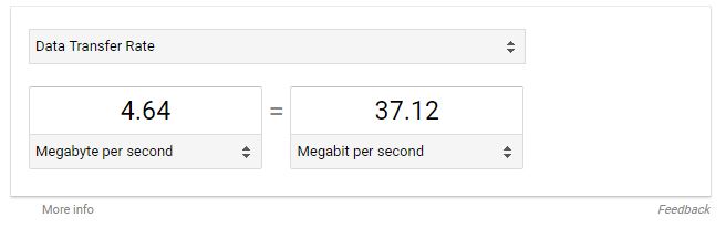

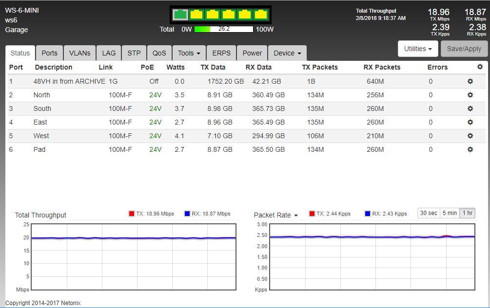

jakematic wrote:The throughput numbers aren't even close still though.
Pretty sure I figured this out.
To be on the safe side I upgraded to the latest FW 1.4.9 and checked again.
This time it dawned on me that the Manager is reporting an 8X difference across the switches.
That can only mean it is actually reporting MBps even though it shows Mbps in the interface - which the converted #s bear out.
So I think it is either a typo, or Manager is pulling MBps when it should be pulling Mbps from the switches.
Sorry to be a pain in the ass... little stuff like that bugs me :crazy:
EDIT: Am totally loving having the Manager, it simplifies things SO much. THanks!
MBps to Mbps
