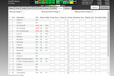

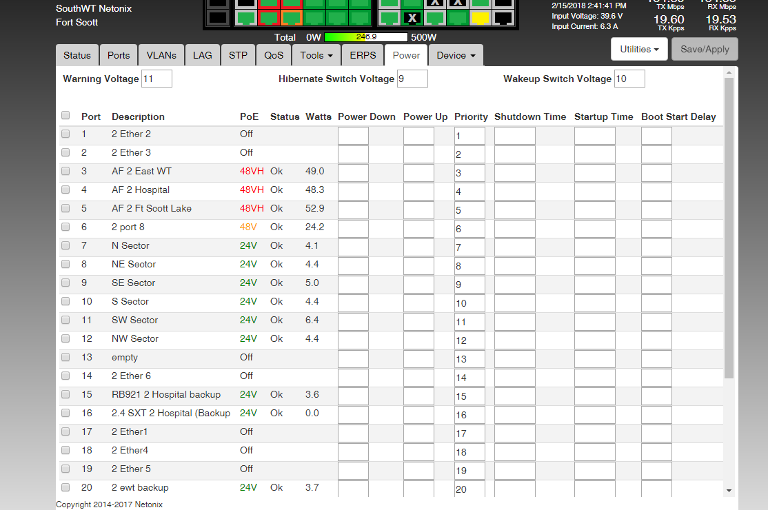

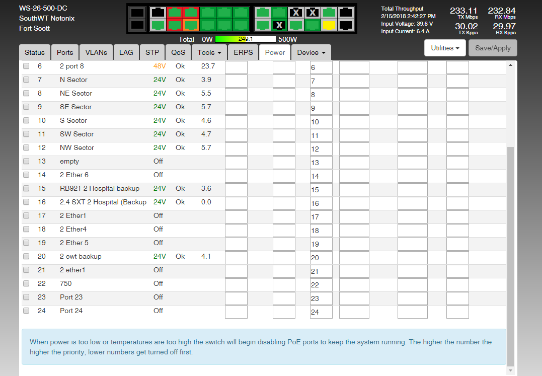

Attached are the screen shots of the Power tab.
As far as how the battery system is configured-
3 X 12VDC batteries in series charged by the Minn Kota charger you recommended. POE Switch is not attached directly to the charger but on a side post on the batteries.
Again, the pictures are of a device that was upgraded this morning. The other switch is not powered up in the system (setting on my desk) since I had to replace it to keep customers up.
david
david

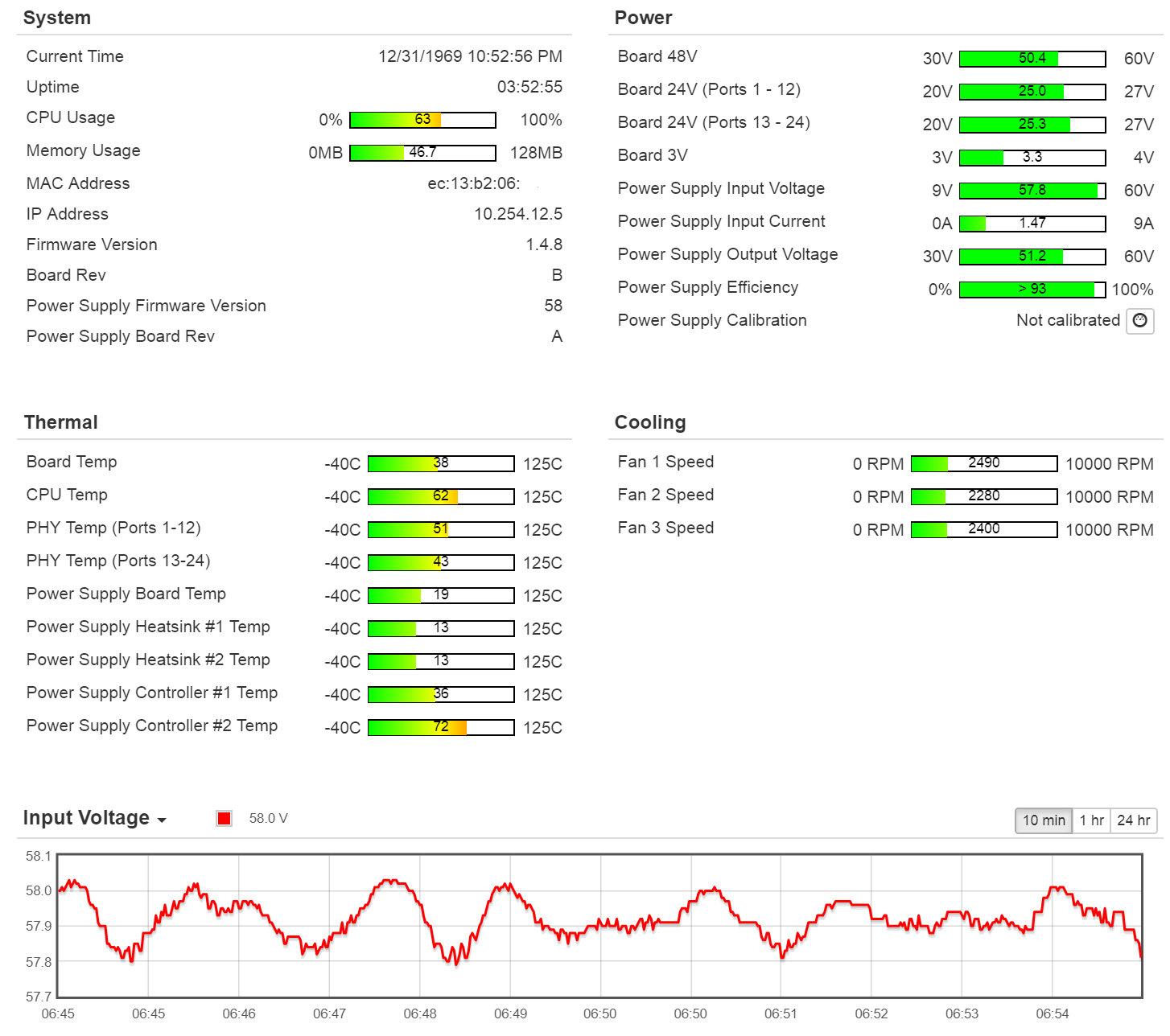

Re: WS-26-500-DC intermittent power issues??
I think were seeing this same issue, so far on most of the switches we have deployed out of our original 6 ordered I believe 4 have this issue. We have one in our office on a power supply, we have one on a AC site with the same Minn Kota
charger and it connected to the battery bank (48 volt), we have one at a solar site (24 volt), we have one on a power supply in the field, and one on the shelf we haven't powered up yet.
At the same time we have two deployed that are not rebooting, and they seem to be on older firmware 1.4.7.
Mat
Mat
- Julian
very interested in system logs post-reboot, if available, I believe it'll be pretty helpful.
