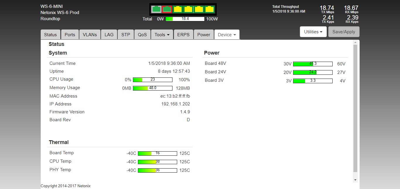

Swap unit and if still occurs please post up more information such as:
Screen grabs of the following TABs
Status
Device/Status
Describe how you are powering it.
Keep in mind there are known issues with some WS-6 and WS-8-150-AC units manufactured early last year and late 2016 where there was a defective CAP that caused reboots.
viewtopic.php?f=17&t=3308&p=21920&hilit=+known+issues#p21920
https://forum.netonix.com/viewtopic.php ... mon#p18176
If this is the case of your unit I apologize but we do warranty this issue for life.
However this is not known to be your issue.
Status
Device/Status
Re: WS-6-Mini locking up in the cold (-15C)
It is -37C here this morning. MINI is snug as a bug in a rug.
