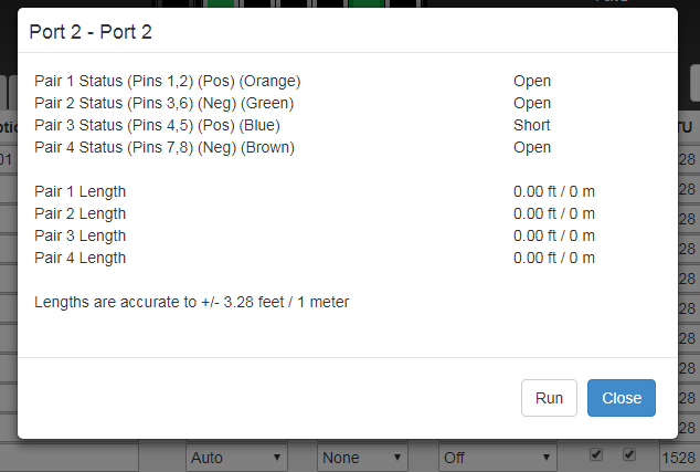

Re: Port 2 Not Working
Have no cable plugged into port 2 and do a Cable Diagnostics and post up a screen grab of that result.
sirhc wrote:Have no cable plugged into port 2 and do a Cable Diagnostics and post up a screen grab of that result.
As requested
Your Ethernet Transformer "appears" to be damaged. Will not know for sure until we open it up but if it looks like the one in the picture below it is damage and not defective.
