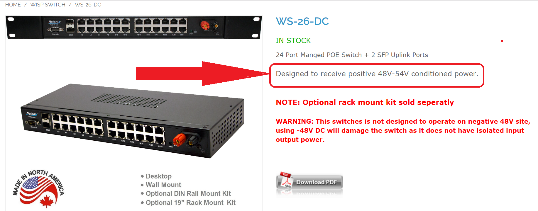

zubair wrote:Ac to Dc we are using a 600W Power supply.
Our SMART DC switches are designed to hook DIRECTLY to the battery bank not a power supply. If your going to use a power supply you should buy the WS-12-DC or WS-26-DC which has no power supply.
Why would you spend the extra money for a SMART WS-26-500-DC when your going to power it with a power 48V-54V power supply? You should but they WS-12-DC or WS-26-DC which is designed for what your doing.
