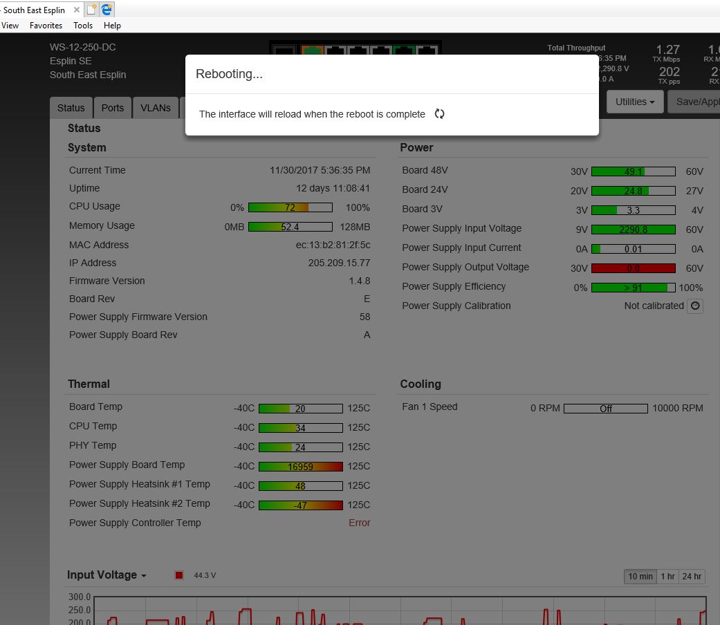

Re: 1.4.8 upgrade, now overheating, voltage says 255volts
I rebooted it, came up and stopped rebooting based on overheating,
decided to leave it till I could drive up on the hill tomorrow and try and swap or reboot with new unit onsite.
49 volt stopped reporting after reboot,
all power supply lines say error,
but still running, hopefully till I can get to it in the AM,
Middle picture was before reboot showing 49 volt, Upper right,
bottom picture was after reboot, not showing empty field where 49 volts was,

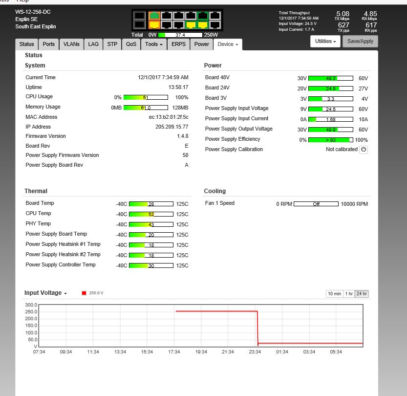

Went to check configuration before driving to site, says is perfect where we have done nothing,
uptime shows 13 hours, all fields show fine,
looks to have fixed itself around midnight based on change in input voltage
- Been thanked: 1362 times
Looks like the I2C communications between the power supply and switch corrected itself.
