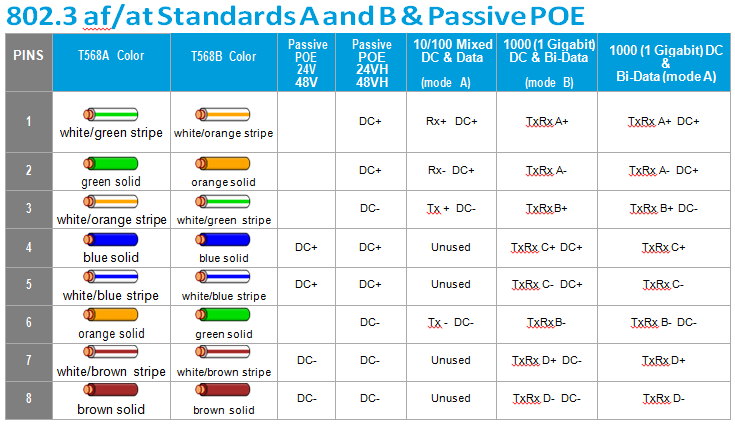

Im struggling with this POE++ concept it seems like there are so many different versions of this ? I have an Alcoma MP400 link and NEC Pasolink pinout as below even though its claimed at POE++ the polarities are not the same. Do you think 48VH can work here?

Your picture has nothing to do with POE polarity it is discussing communications + and -
Therefore you need to follow the instructions laid out here in this post: viewtopic.php?f=6&t=1178#p8809

So now that you know what the PIN OUT is (which is in our Spec Sheet on page 17 and in the product description on our web store) all you need to do is look at the spec sheet from your device and see which POE option you can use.
If they do not specify the PIN OUT polarity break out a multi-meter and but one end off of a patch cable and strip the wires and figure it out on your own.
Also if they have a bridge rectifier circuit like MIMOSA the device will swap the polarity the way it wants it.
WARNING - If your equipment is not specifically designed to accept power on all 4 Pairs do NOT use a VH POE option.
So if you own a Volt Ohm Meter simple use it to map what polarity the provided POE supply is providing on what PINS.
From what I can tell the radio says it uses 802.3af/at with a MAX of 35 watts so 48V should be OK??????
You need to map out the provided POE adapter to be sure.

We follow the 802.3af/at polarity PIN out.
Our switches will power any 802.3af/at device with 48V POE option - DO NOT USE 48VH
We explain all this in detail here: viewtopic.php?f=6&t=1178#p8809
And this chart is in the PDF Spec Sheet: http://www.netonix.com/media/wysiwyg/ws-specsheet.pdf
