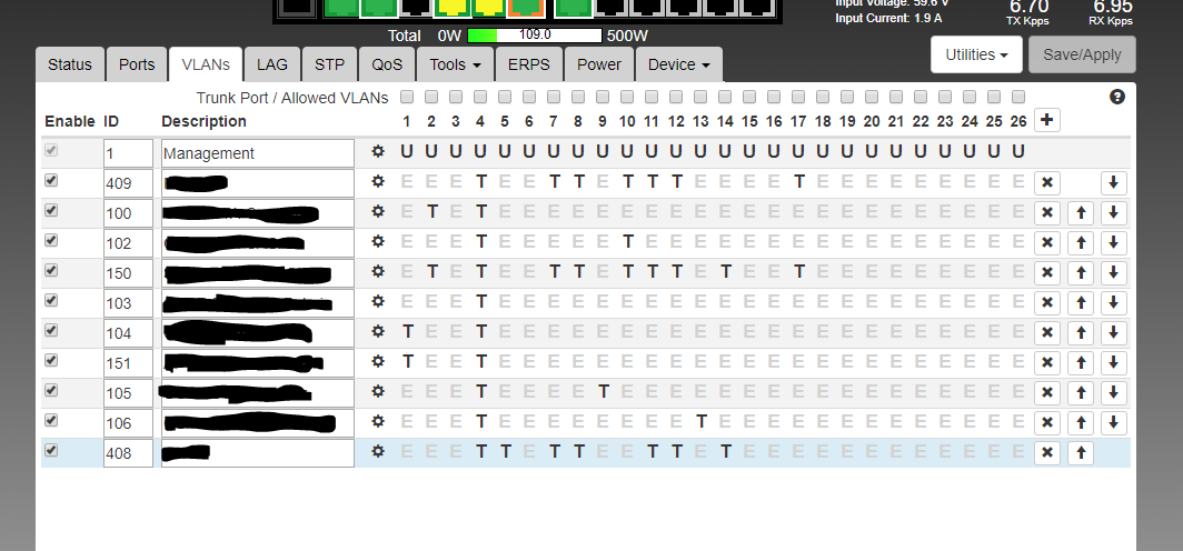

https://i.imgur.com/muSNvKu.png
Right now, someone made a change in config to an AP and it went down. Apparently, if anything causes the port to drop and come back up, it'll lose communication.
Dec 1 12:32:39 Port: link state changed to 'down' on port 17
Dec 1 12:32:39 STP: set port 17 to discarding
Dec 1 12:32:40 Port: link state changed to 'up' (100M-F) on port 17
Dec 1 12:32:40 STP: set port 17 to discarding
Dec 1 12:32:43 STP: set port 17 to learning
Dec 1 12:32:43 STP: set port 17 to forwarding
We tried changing the AP to a new one. No mac.
We tried new cable. No mac.
We tried changing ports 3 times. No mac.
Reboot the whole netonix physically and everything comes up. Remote reboot does not work.

hfa@omeganetpr.com wrote:https://i.imgur.com/muSNvKu.png
1) Please upload screen grabs as defined in my footer which makes it a lot easier to view screen grabs. Upload each TAB as a separate file. Do not make a new post go back and edit your post with the link to the screen grabs. Also do not block out port descriptions if they indicate the type of radio or device on that port. If you have some information you do not want then edit picture but let us know what device is on each port in the port description.
2) You should disable STP/RSTP on any switch port facing an AP and the radio itself, reference these posts:
viewtopic.php?f=6&t=3225&p=21369&hilit=+disable+AP#p21369
viewtopic.php?f=6&t=3165&p=21093&hilit=+disable+AP#p21093
viewtopic.php?f=17&t=3086&p=20855&hilit=+disable+AP#p20855
