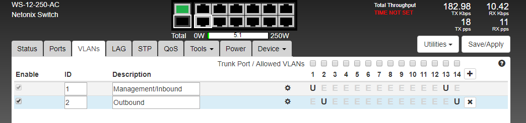

I need to know how it would be possible for me to link only port 1 and sfp port 1 then port 2 and sfp port 2, reason for this would be i want to use port 1 and sfp1 for incomming internet traffic and port 2 and sfp2 for outgoing internet traffic but they should not communicate with each other. would this be possible on this? usualy on a mikrotik i would just create 2 bridges but im new to WS netonix switches. Also would this WS-10 48VH switch be able to a SIAEMic radio?

Sounds like you want to use internal VLANs.
Bear in mind that your switch's management IP will only respond on the VLAN at the top of the list, but if I'm managing the switch from the inbound port, it'll look something like this:
Note that all other ports other than the ones you listed will be disabled in this configuration.
