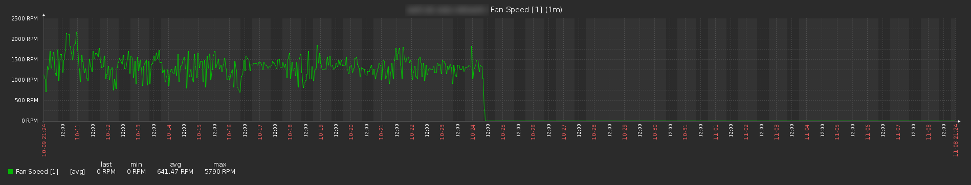

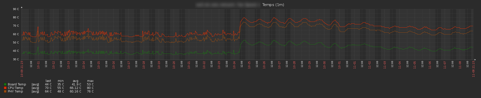

The fan in one of my switches gave up :(
This was in a fairly small enclosed room with minimal equipment inside - we had a hot summer, at times it was running at 6000RPM 8 hours/day, for weeks. Fun fact: according to my monitoring, it rotated approximately 658 million times before croaking.
This switch is outside its warranty period, am going to replace the fan myself (with the handy replacement part sold by Netonix :)
The little fan that couldn't

That certainly seems to be a contributor. One of our recent failures was in a switch located in a clean, temperature controlled indoor environment, but the rest have been inside outdoor enclosures at remote sites. Being enclosed they don't get real dusty but they do get very hot in the summertime and the fans run full speed for many months. The biggest concern of course is a fan failure in the summertime can quickly spell doom for the whole unit. However, when they have usually failed is in the Fall when the ambient temperatures cool down and the fans begin to modulate their speed. With the reduced speed input, the fan will seize and go to zero. The switch temps then soar. Sometimes the fan will then restart and run intermittently as temperatures rise and fall but sometimes they don't restart at all without mechanical help.
