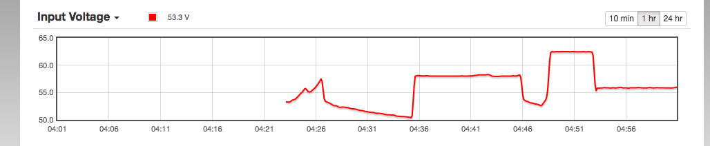

Attached is an image of the Netonix's voltage graph upon connection of the smart charger... The switch would reboot when the charger is in it's float/trickle stage, especially in the 5am time frames (being the coldest hour - the chargers are temperature compensated {we're in coastal California - so it's never very cold}).

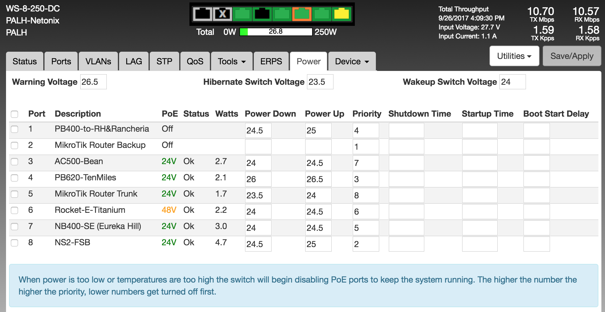

What do you have set for the shut down voltage of the switch?

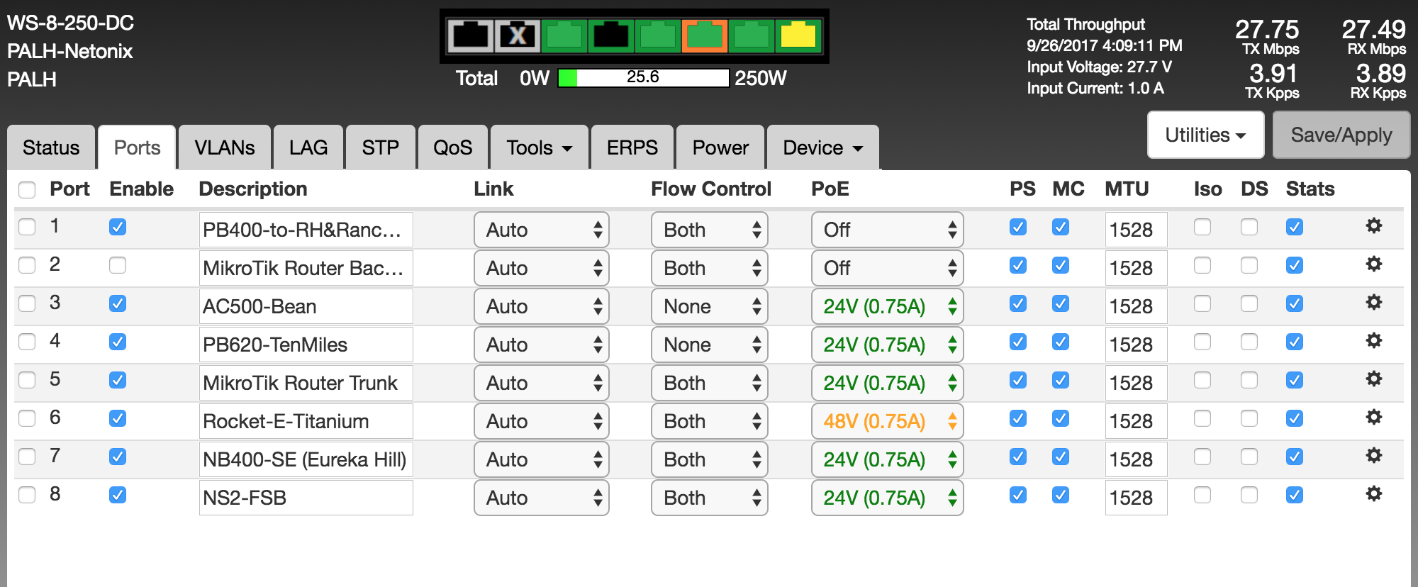

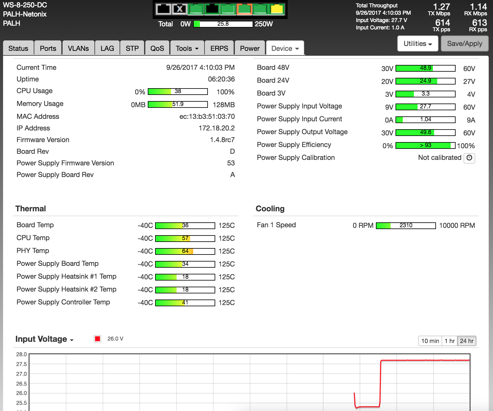

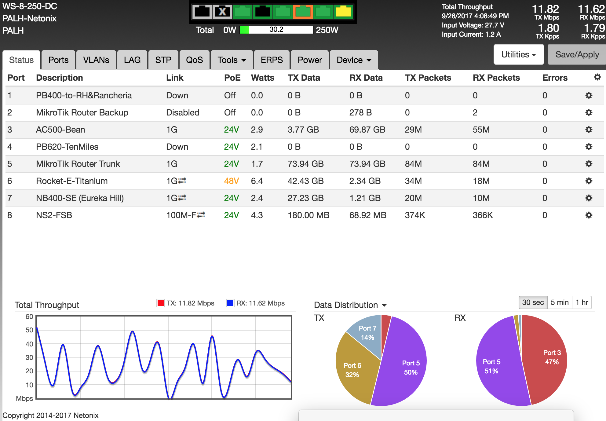

Attached requested screenshots of (one of) the switches that rebooted earlier today when the area lost power.
Yes - we can power-off the charger and the switch (used to) remain working - now it reboots and comes back (with the charger still off).
The voltage for hibernate, as shown in the screenshot, is set to 23.5 for this switch - but voltage never dropped that low.
Another switch that rebooted today is a WS-8-150-DC which does not have hibernation feature.
Yahel.
